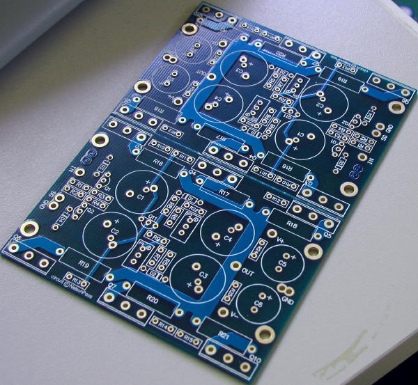

I have 75pcs of F4 amp boards shipped to me today, should receive them in 3 days. 75 more pieces will be shipped with F3 boards which are already in production.
The amp board has a scoring line and is good for two channels.
The PS board is good for symmetrical supply in stereo setup. If you want dual mono, you will need 2 PS boards.

I received 75pcs of F4 boards yesterday.
All the current orders will ship today by air mail, 30 boards are still available.
75 more pcs are coming in 2 weeks, together with F3 boards.
