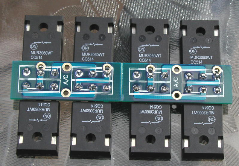

Looneytunes said:Are you still planning to post more information regarding your power supply board? Now that I have the board in my hand, I’m thinking that it would also be great for small projects, such as the Pearl external power supply that I never built.
I'm glad you all like the boards, they came out pretty nice indeed, with thick traces and nice shine, and the color that is neither blue nor green
The PS board was supposed to be truly universal, I tested the diodes configurations this morning and it all works fine. Here a short outline:
The rectifier section is supposed to be separated and high power diodes mounted as in a picture below (they can be attached directly to a chassis for heat dissipation, isolation pads needed). The board is designed mainly for 3 pin rectifiers, but will work with other diodes packages as well. Here's MUR3060:
