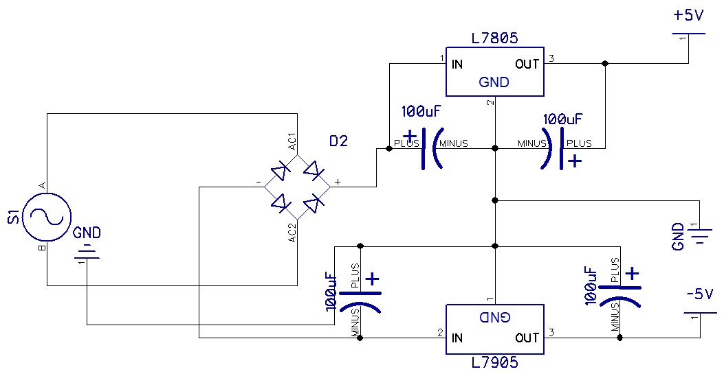

I need some help figuring this out and YES I am a noob
The problem is that the voltage I am seeing after the 7905 is about -8.5V when it clearly should be -5V
I have tried several 7905's with the same results.
I do get +5V from the 7805.
and I get -12V and +12V directly after the rectifier
I have used the same 7805 and 7905 with a ATX power supply with +/-12V and that works great.
I have attached the schematic.
Any ideas would be great.
Thanks.

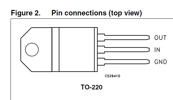

IIRC 7805 and 7905 have different pinouts. Did you verify?

I am using TO-220
What is that about the case being Vin? See attachment.
And no, the 7905 is in a breadboard and no other component is touching the case.
Vin is on the case of the 7905
See datasheet. www.jaycar.com.au/images_uploaded/LM7905.PDF
Pinout is Common (Gnd), In, Out, looking from the front. Carefully check your wiring, particularly gnd of 7905 as it appears like a component not in your diagram but on the board is lifting it higher. Your diagram shows 2 ground wires ?, perhaps you are providing paths for 7805 and 7905 yet they are joined on your diagram at the regulator pins. Can you see why two wires are unnecessary if already joined at regulators. Two wires to a common point is nice but circumvented if the regulators already share gnd.

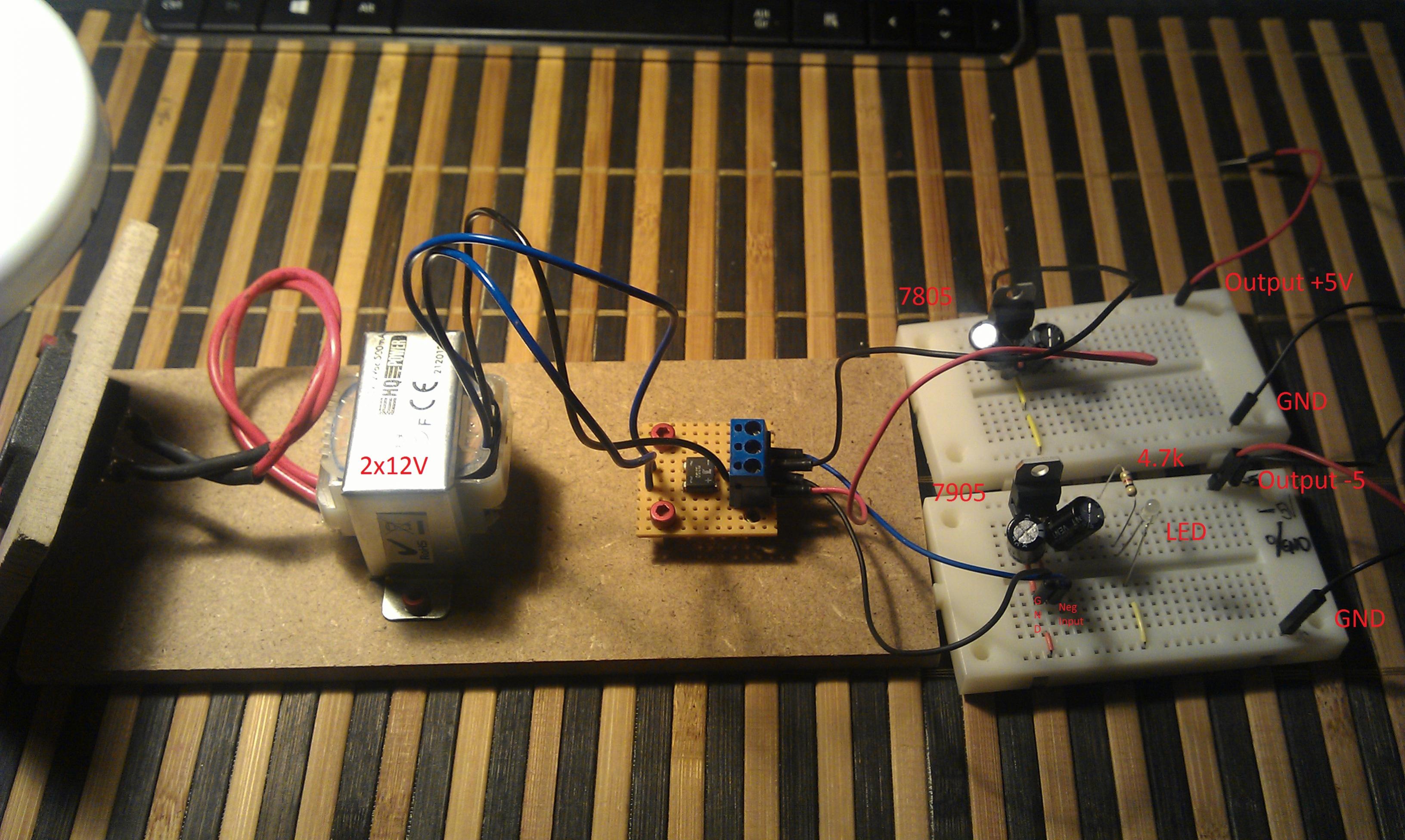

I have tried to figure it out myself but didn't want to burn anything up so I thought I would ask.
I have tried connecting a 4.7K resistor and a LED between negative output from 7905 and GND to put some load on the 7905 but the only thing that happened was the voltage dropped from about -8V to -7.12V
I have attached a picture of the test setup.
I don't think I can put the caps any closer to the 7805/7905
