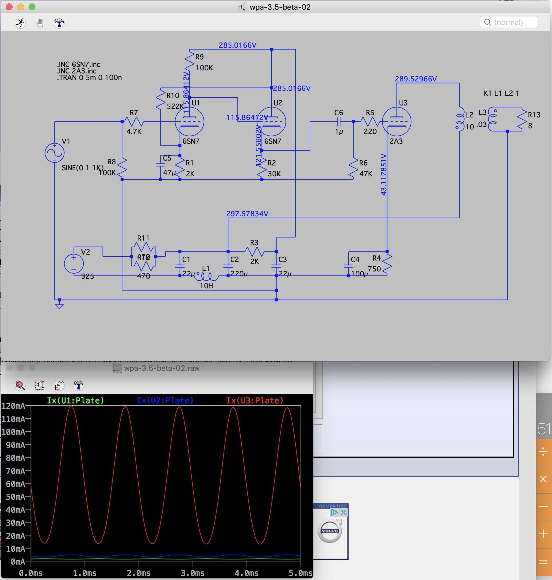

Two questions I'd like to raise re: the WPA 3.5 voltages that have been discussed here and in ClefChef's other thread on the matter: Wright Audio WPA 3.5 Humpot & schematics.
* Is the 120V of positive voltage on 6SN7 grid 2 harmful to that triode?
* I calculate the 2A3 to be running at 14W plate dissipation (290 - 43 * 0.057): is this too close to the 15W maximum listed on the RCA datasheet?

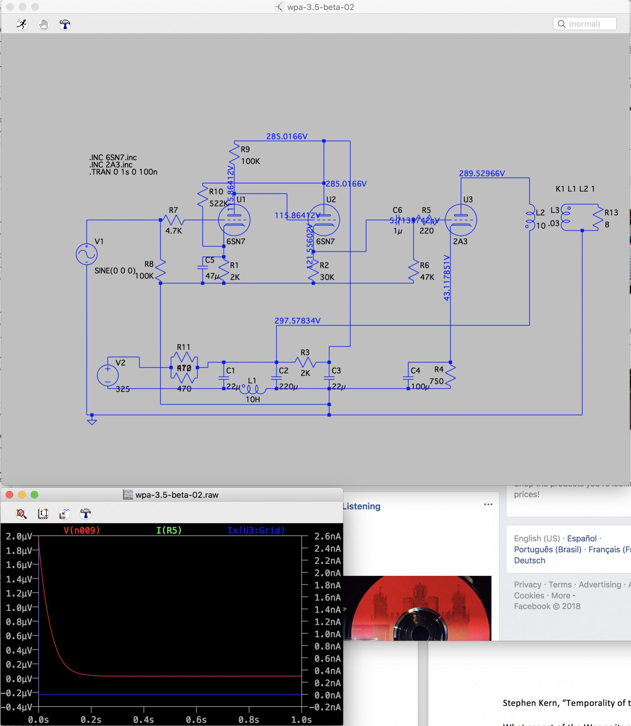

I drew my own schematic from available pics, which corroborates ClefChef's, and also simmed it in LTSpice (screenshot attached), which comes out very close. The signal sine wave looks good and I'd like to try breadboarding it but am worried about that positive grid voltage and the close-to-max dissipation.

Is that the goal of that cathode follower - to drive the 2A3 grid positive (A2)?
I played with your number some in SE Amp CAD ( not an expert with the program ) and it shows 2A3 responding to it - looks like 5 volts positive gets about an extra 3/4 watt.
I think you're okay to go ahead and breadboard it and give it a listen.
