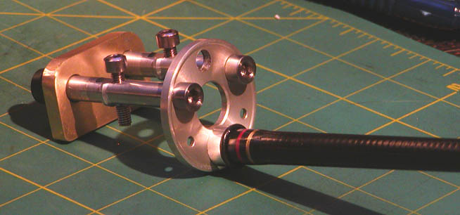

Here is what i did so far.
First i will try with "spikes" on the bottom of the adjuster screws.
if its not so good i will try knife edges
front bolts are Ti. hollow threaded rod inside the arm tube (about 1 inch) is Ti
adjuster bolts are aluminum and there is a spring and tiny piece of brass inside the top bridges pressing against the threads to keep them nice and tight.
the rear bolts holding on the bronze are nice heavy steel ones

looks very nice. A few things i'll point out though. I assume this if for a ladegaard arm? From what ive read the stylus should be at the pivot point, it looks like your arm is slung down low.
The counterweight should be as low as possible and really should be below the pivot point. And the whole assembaly that moves in the vertical should pretty much be as light as possible.
Going by those points your arm tube should be higher and the steel bolts at the back are a bit of a worry.
I may be completely wrong, i really dont understand these things, im just going by what ive read (which may also be wrong )
Either way, it looks alot prettier than mine does.
I dont thing 2 points will be any worse than a knife edge, just dont think it will be any better either. I used a stanly blade but ground away the center so it sits on two small edges.

I use one knife and one spike on my arm. The spike is working against four tiny balls pivot assembly; all taken from the old discarded arm. The knife is resting on two triangled bronze pins making V-bead. So, I have constrain against slipping along the slider, which knife bearing alone haven't, and I should not care about precise distance between two pivot points, which otherwise becomes huge problem for two spikes.First i will try with "spikes" on the bottom of the adjuster screws.
I have taken note of the issues with my design. but it is a lot lighter than it looks the aluminium bits are hollow. I will make some changes this week.
I have another one (almost entirely carbon) in the works as well. It is pretty crazy looking
The great thing about this is you can make different arm s and just swap them as long as you set up the wiring so it can be changed without too much hassle. I am thinking of using a gantry
then I can try both and see which one i prefer or remove them for modification or make new ones.

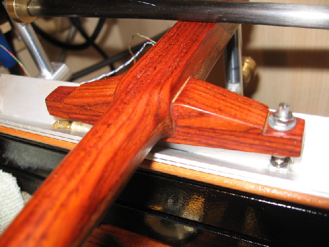

Livemusic thats nice. is that carbon rod on eccentric pulley a cueing device? it looks like it presses down on the back of the arm.
Ive been doing a bit more messing, damping the carriage and the knife blade. It all helps. Ive also been playing with air pressure to vary the air gap but havent noticed any change in sound.
I have found a nice highly flexible wire for it though
http://www.satcure.co.uk/accs/page13.htm
I was given a small sample which i spliced in to see if it was supple enough and its completely solved my tracking and VTF problems so i ordered enough to wire the arm.
Im in the process of making another air bearing as im not happy with the current one, im trying to get the two pieces of angle to fit together as well as possible to make the bearing more stable.
After lightening the arm as much as possible (i took out quite alot) its alot more stable. But im not sure if ive lost some of the sparkle/transparancy and replaced it with treble distortion or if im just getting used to the arm. I really didnt listen much before i started modding.
