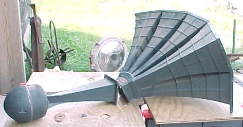

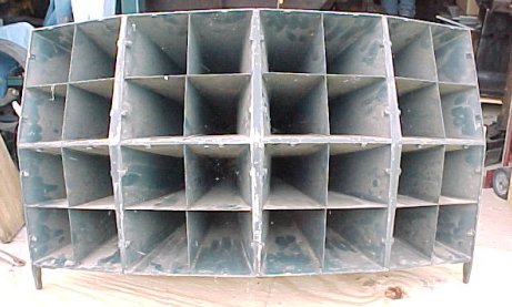

Right, no free lunch and too much cost/work for me. Since you liked them though, I bet you'd go freaking nuts auditioning one of these 'rara avis' [32] cell Jensens rotated vertically with your corner Klipschorn XO'd at ~ 300 Hz. It's so long you may not even need any digital TD:
edit: At least multi-cells are easy to passively taper by ear, adding stuffing of varying density to the outer cells.
