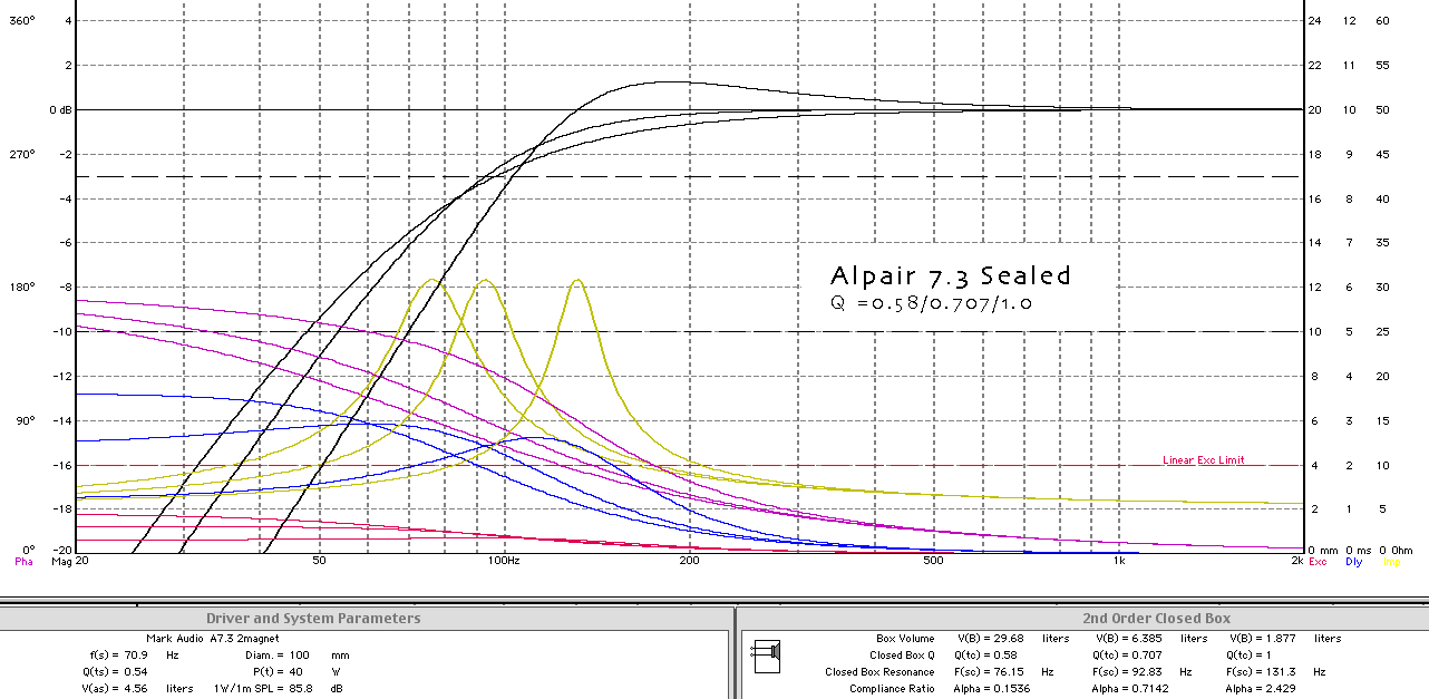

How does the 7.3 behave in a sealed enclosure? What would be the effect of a 10" wide baffle?
I was thinking of making a single speaker with two sealed compartments. One for the sub and one for the Aplair. Just have a single baffle width. 10" would be probably the minimum I could use.
