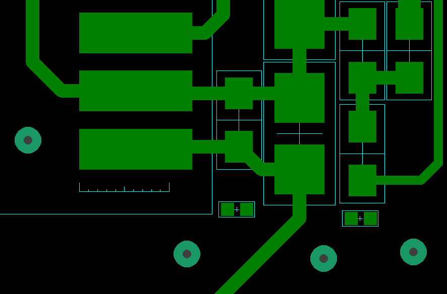

And I have very good eyesight, but it's clearly at the limit of what I can handle. The big magnifying glass_with_light doesn't do it for me and the Mantis stereo microscope also doesn't make it easier.
