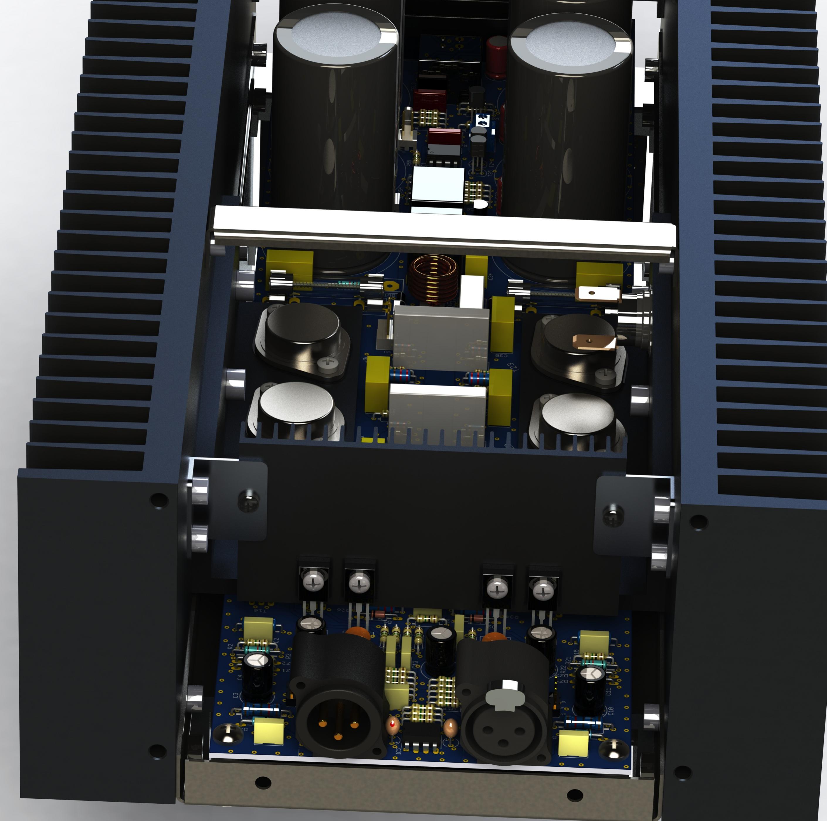

In the mean time, my other renderings are now done, so here are a few more:

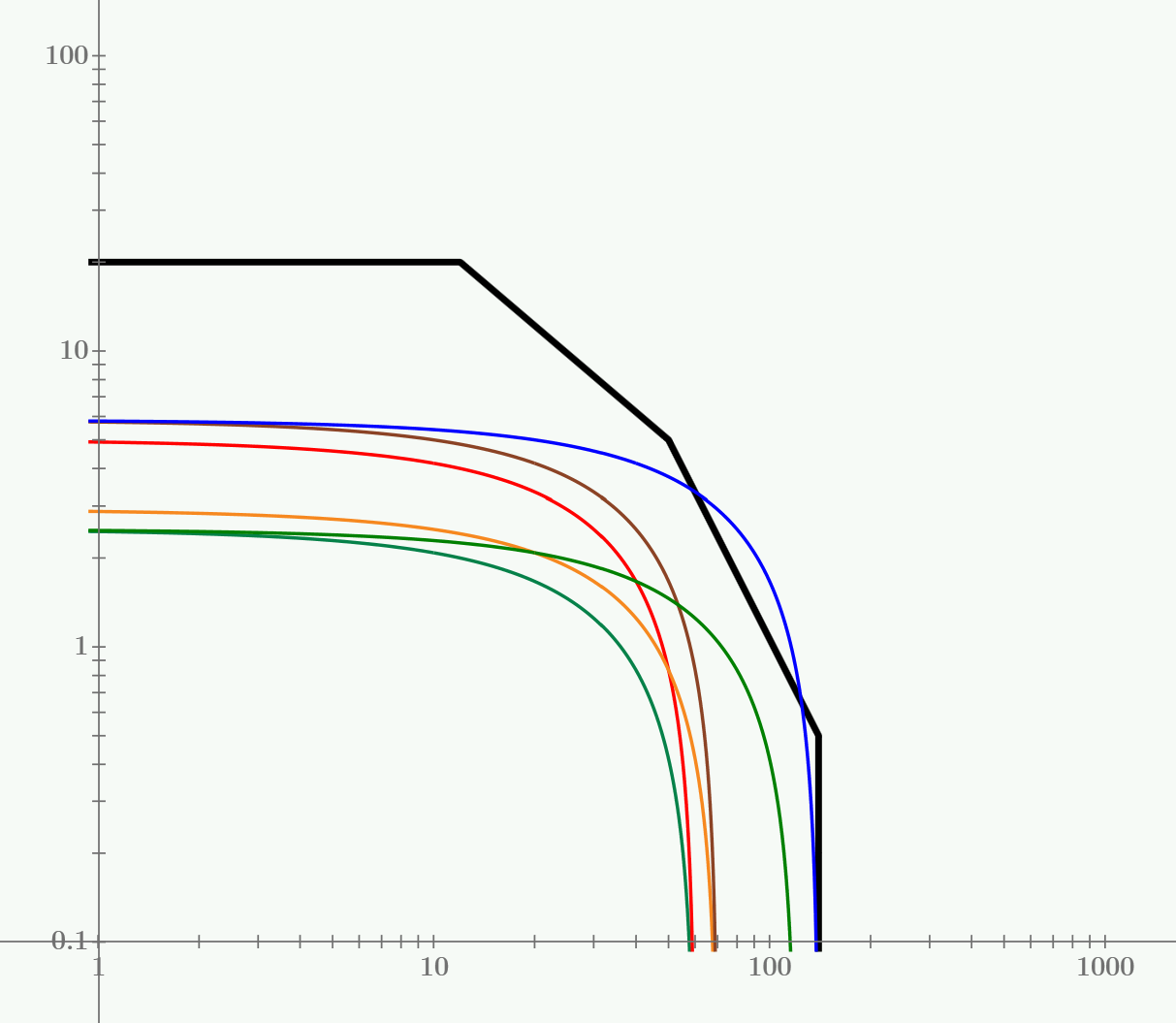

I have access to a mathcad setup for now, so I am trying to use this to make some graphs and calculations, but I'll need some help figuring this out properly, as what I'm doing may not be quite right. I'm on Mac, so no MathCad for me, but I'll touch that windows thingy anyway (yuk!) just to get the work done.
Here is a graph I managed to make with it. I plotted the SOA from datasheets for the MJ15003/4 in black. I think I may have this right, since it looks like it's matching the datasheet's graph. Then I plotted 2 sets of load lines, one for Vcc at 60V for the 60V rails that I'm using on this current design, and the second for 70V.
I don't know how to add captions on the graphs, so I'm just going to provide the legend in text.
For each set, I plotted for 8 ohms and 4 ohms for a pure resistive load, which I may have gotten right, and I also tried plotting a 100% reactive trace.
The green traces are the 60V Vcc for 8ohms resistive and that possible 100% reactive load situation. I need to make sure I get this right, as it's quite near the limits. The red trace is just the 4ohms resistive on 60V and the orange and brown are the 70V Vcc versions for the 8 and 4 ohms.
Then there is that blue trace, which exceeds the SOA, which is supposed to be the 100% reactive condition for the 70V Vcc on 4 ohms.
All these traces are for 3 pairs of MJ, and that is also something that I need to double check to make sure I got it right.
If this is correct, then the 8ohms 100% reactive situation on 60V rails passes with no problem, but the 70V rails would pose a problem.
On pure resistive there are no problems anywhere...

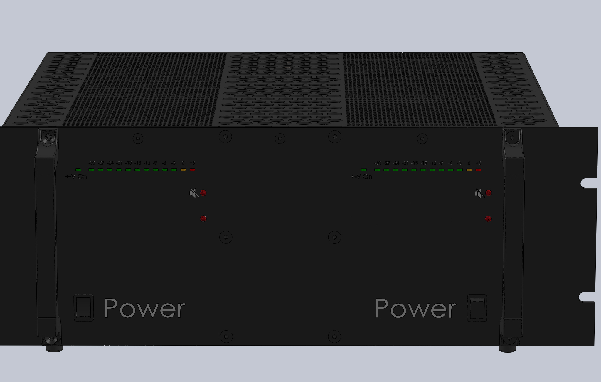

Very impressive layout and renders but will you actually make it?
Of course, that's why I'm doing all this, it's not just to fool around, I have many of the parts already, which is the main reason behind some of the choices, plus I am right now working with a contact of mine in china who can handle the sheet metal work, they have the equipment, including the laser cutting table.
This will be nice, and I plan on other versions, but keeping a good part of the case the same to limit costs.

I have 2 toroid transformers for this amp, 470VA and about 43V with no load, so my rails should end up close to 61V unloaded. I don't know how far they'll sag under load, but the toroids are pretty efficient and don't sag that much, so I'm expecting a power somewhere in the 180-200watts on 8ohms. We'll see how that goes when it's built.
The main heatsinks are Fischer SK479, the smaller heatsink for the pre-drivers is an SK546 and the one on the rectifier bridges is an SK597. The angled profile for the TO3s to link up to the main heatsinks is also from fischer, SWP55 anodized black.
The plans I'm making aren't just for show, they are precise and ready for manufacturing. I just forwarded the cad drawings to my metal worker in china and we're chatting about it as I'm writing this...

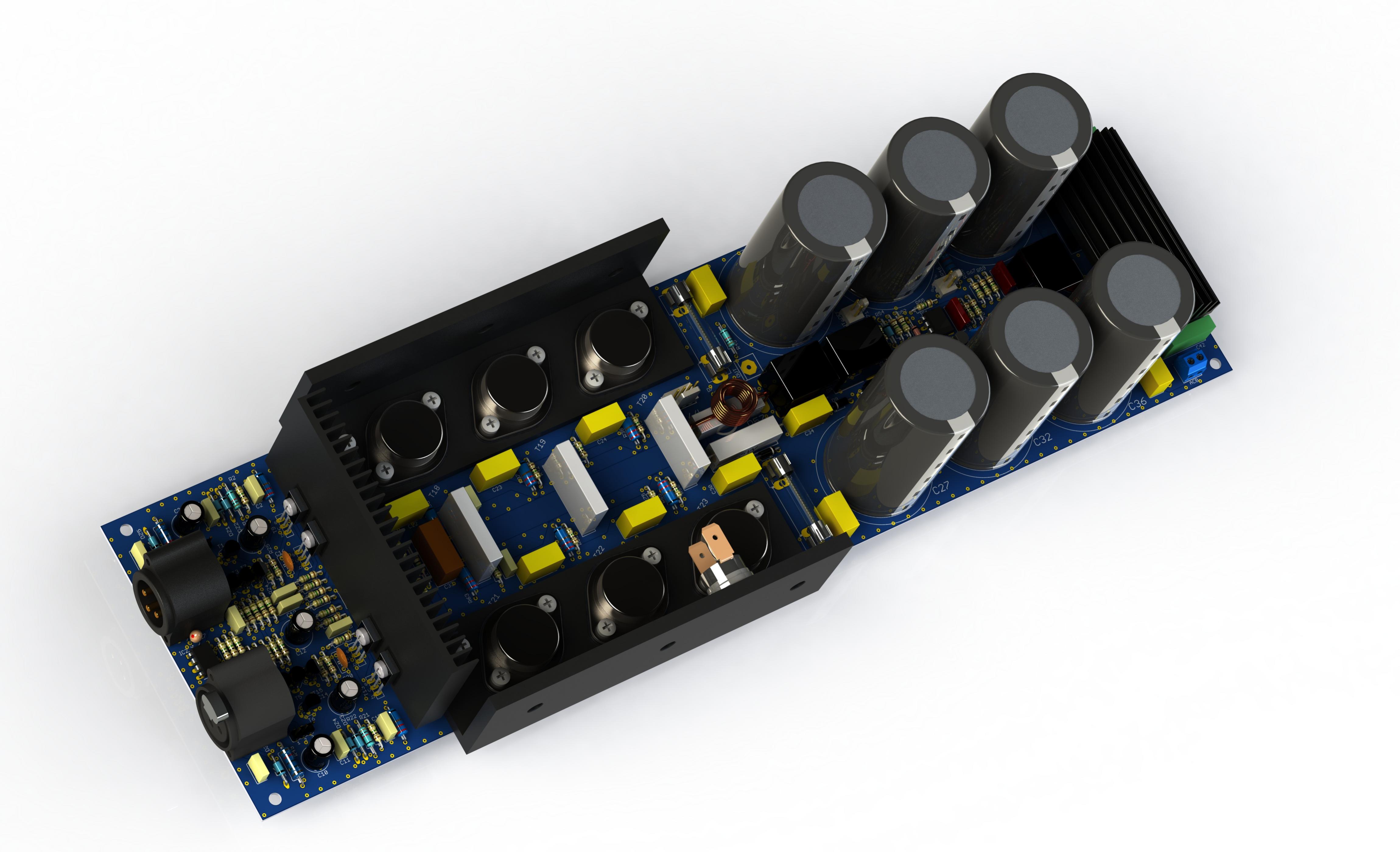

On the pcb layout and the renderings, I used a 5W axial power resistor as the base for the output coil, and the drawing shows a coil of about 11-12 turns on a roughly 6mm inner diameter.
That takes some pcb real estate and perhaps there is a better solution that would give more room around them for evacuating the heat while providing a little more space for connection to the output. Perhaps a radial power resistor, but then the coil would have to change a bit.
What's the optimal value for that coil? If I have to make it a little bigger, how does that affect its value and how can I know what to wind???

Not sure what software you are using, but Eagle standard pads are on the small side. You may want to check for manual solderability.
Consider adding a second set of output device pads to allow using TO-3 or plastic output devices. They could be covered by the TO-3 insulators if those devices are used. Although MJ150xx are reasonably available, plastic devices are more so. That would make it more universally buildable.
MPSA to BC is easy - just reverse the orientation. No need for a board change. That's what I did on my Jens Rasmussen boards.
Don't worry about heat dissipation of the output resistor//coil. The only reason that resistor will see any power is if you have a high frequency oscillation. Smoke means a problem elsewhere. The coil is there to keep EMI/RF out of the feedback path. It's value isn't terribly critical. I'd lean a towards the low inductance side to keep the bandwidth up.
I agree with earlier posters, a finer mesh over the circuit board would be a good idea to keep flotsam and jetsam off the board and shouldn't add too much to the cost if you just add rectangles of finer mesh. Perhaps better looking would be a solid top with cutouts for the heat sink areas of open mesh.
I am using Eagle.
Which pads are you referring to? I made quite a few of my own footprints, mostly because either I didn't like the smaller pads and other details from eagles' built-in libs, and also because they were not there. So when I make my own footprints, I tend to be heavy on the pad size by default.
I need to double check, but if you can point me to the ones you have in mind, I'll definitely recheck them.
I have to make sure it all can be done by hands, especially for me now that my eyesight has gone downhill big time in the past few years and my dexterity is also a disaster, so I do need to make it as easy as possible.
That requires making new footprints and I would have to move tracks around to leave the room for them. I planned to switch to the flat packs later in any case, so I didn't think it was important to make it that versatile right now, since I planned other versions.
But if that can be done easily enough, why not?
And perhaps more "group buy ready" and make it more affordable...
I was giving some thought about making those footprints more of a staggered instead of straight line type, so the pads could possibly be a little bigger and be pulled apart a little more, which would probably allow for a wider clearance in the design rules. This is where most of the clearance errors occur if I try to increase the clearance width, so perhaps going for more spread out pads on those cases could allow for a higher clearance on the whole board...

Well, I'm thinking I can make a slightly different version of the top case cover, so it has a different and tighter mesh right above the pcb. This would only be a change on one part and that would not change anything in the costs, since those will be laser cut on a table. I'll work on that and post a possible option real soon...

The way I had thought of doing it with the current design is that the XLR cables would be the ones making the difference in the way they're wired, so if the amp is hooked up to a non balanced device, the cable would be wired to handle that negative input tied to ground, so the amp would never know about it and there would be no need for any switches or config of any kind on the amp itself. That of course requires XLR cables wired differently and have them on hand to use on their intended devices.
I was doing some reading on that A75 article and couldn't find the part that I need to read, however I went on reading some really interesting stuff.
I do need to learn more about making proper use of that other side of the diff amp though. Where in that article is the part I need to read first??

Ok, for the wary of spills and other types of intrusions into the amp, I made a different version of the top case cover with a finer mesh only on top of the pcbs.
I made holes only 2.5mm, and there are many...
Is this more satisfying?
We can still see the innards, mostly... It still looks rather nice I think (any comments on that?) and it should prevent many intrusions, although nothing can prevent the liquids intrusions, as only a water tight case would do that and that is the last thing we'd want on the amp.
I don't think there is anything we can do against a full beer can spill right on the amp's top, only a case with no holes can help that somewhat.
But when it's time to make the case, my version will be the first one, at least for me, but the choices exist. We can even make those holes smaller if that still scares some...
It is not only safer but looks even better too.
The electrical safety standards have details for maximum hole size, would be clever to comply with these.
Very nice work, what software did you use to render?
Best wishes
David
Best wishes
David
What are the standards for that? and for where? Because that can be done in many countries and although some don't have such standards, those that do will not have the same from one country to an other. Difficult to comply, and to find all the info.
Would that 2.5mm that I used be a safe bet?
Actually, those last few snapshots aren't renderings, just plain picture outputs from solidworks. (I have access to one right now, so better make good use of it)
I only have looked at the standard for Australia and I don't remember the details.
But I assume the different national standards are fairly similar.
You could pick the minimum from the major standards.
The Australian Standard is pay to view but you may be able to find some others on-line.
Perhaps UL? There is probably a Euro-standard available somewhere too.
The IP standard should be available.
Best wishes
David
OK. 2.5mm is IP3
1mm is IP4
