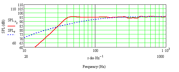

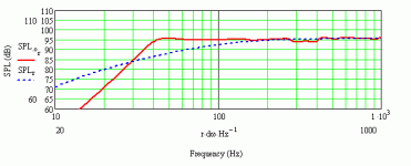

Hmm. Those specs. don't completely gel. Working on the assumption that Bl is the more accurate, then Vas will be somewhat higher than indicated here; ~165.44 litres.
Anyway, based on those specs. (adjusted) then a Vp = Vas MLTL would work pretty well with the Corals alone, although it's a v. big box,
L= 48in
CSA = 210in^2
Zd = 19.75in
Zp = 45in
Vent = 6in diameter x 1.25in long. Line top back & one sidewall with 1in acoustic fibreglas & adjust this & vent tuning to taste from there as it's a max-flat alignment. Doesn't have massive headroom, but better than some; total displacement stays below 1mm 1m/1w.
If you wanted to go multiway, you'd probably do worse than something from the Eminence line -if possible, go for a 15in model. Beta 15, one of the Deltas or Gammas etc. Whatever takes your fancy really; they're all pretty good for the money. Get them in a suitable vented box & the Coral on a small baffle, cross them at about 200Hz or 500Hz depending on what you're after & you've got your own Basszilla clone that'll blow most commercial gear out of the water.
