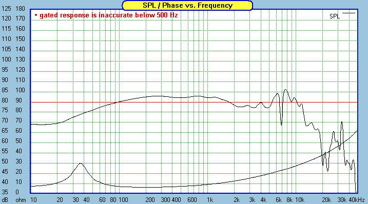

The tweeter is fairly decent, I've used a pair before. Resonance is at around 2000hz, but its almost non existent, in that it's very very well damped. This has the knockon effect of allowing you to cross closer to the resonance without it being as much of a headache.
I did a design where the crossover was around 2200hz, but here the response is 33dB down by 1000hz. Plus the system is never played very loud (its in the kitchen where my mum uses it), nor would I encourage it being played loud.
What this means is that I would not recommend it be paired with the dayton drivers, what with them having metal cones and generally requiring lower crossover points.
I'd be thinking 3khz 4th order for guaranteed safety.

Ok....Forget the Daytons. After looking what seems like hours on end at well over a dozen woofers, I think I have narrowed it down to these two. The Mach 5 MLI-65 and the Fountec FW168. Both links lead to mfg. T/S and freq. response sheets. More info can be had here at the Zaph Audio site with more complete charts and both woofers listed. Just click on the appropriate model number for the proper info. Being a relative noob to all this, each appear to work out to 4khz before they start breaking up real bad but, I'm no expert at reading these charts so you tell me. The Fountec does have an aluminum cone like the Daytons but, it appears to not break up as early as they do. Which would be the best value for the $$$ MLI-65 ($36.00) or the FW168 ($45.15) ?
The FW168 is a better driver, but requires a crossover around 2khz at the minimum to make the most out of it.
See the issue with metal cone drivers isn't the breakup (ringing) they exhibit, in this case the double peaks between 5 and 7.5khz. But how this impacts the distortion further down the line. You will notice that the 3rd and 5th order harmonics peak also, but at around 2.5 and 1.6khz.
This is why zaph recommends a 2khz 4th order or lower crossover, something that your tweeter wouldn't be too thrilled about.
Even if you were going to cross higher, the double peak breakup would require some serious work to get it out of harms way.
The MLI's distortion isn't great, but the one thing it does boast is a smooth roll off, making it far easier to work with.
