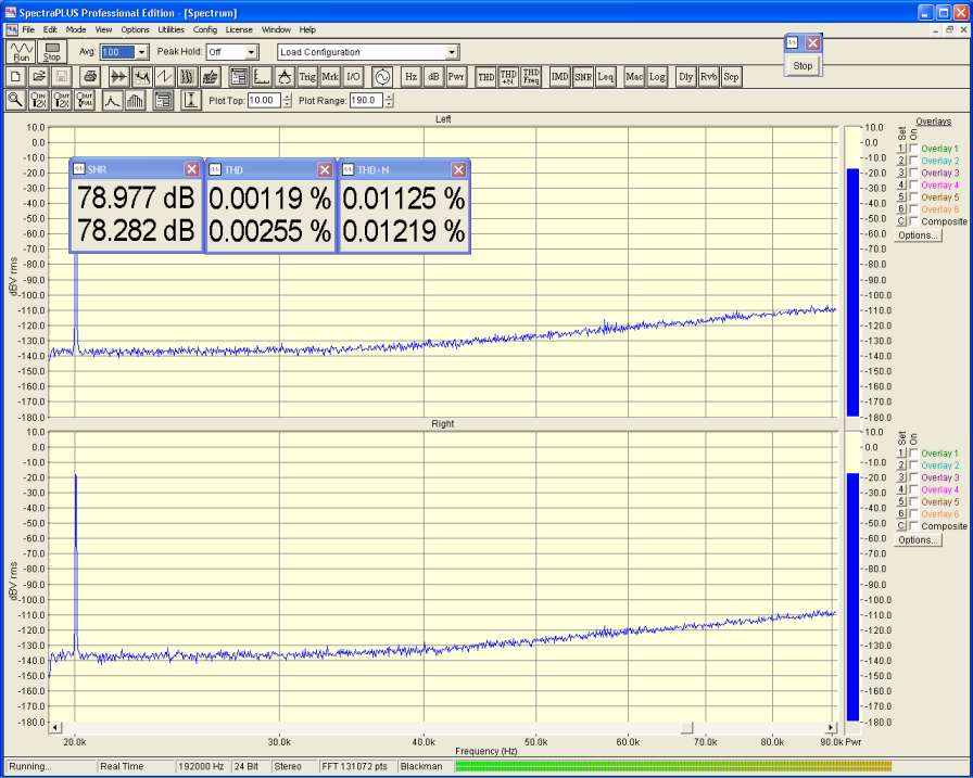

I just asked in a thread on the high-powered version, and the reply was "Less than 0.1% at rated power, and less than 0.01% through most of the powerband." The profile is probably similar to that in the figure in http://www.passlabs.com/downloads/articles/susy.pdf (p.1 bottom right) although that amp is one cascoded stage instead of two stages, and doesn't use a modulated current source as the Aleph-X does.smoking-amp said:The Aleph-X
Any dist. data available for this design? Particularly versus signal amplitude.
