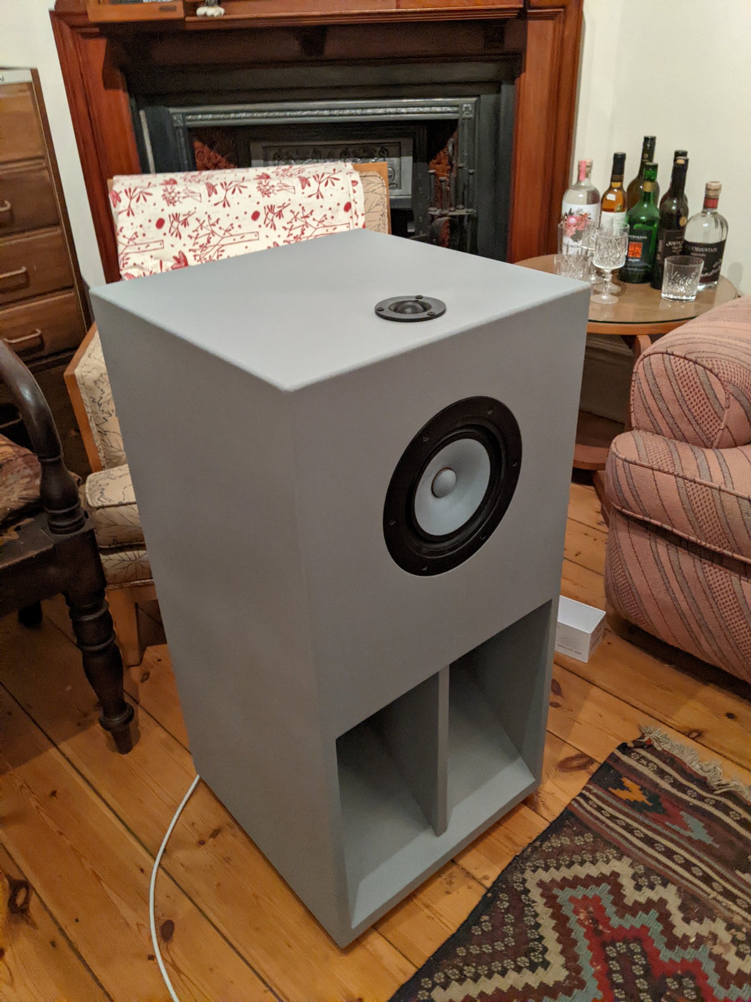

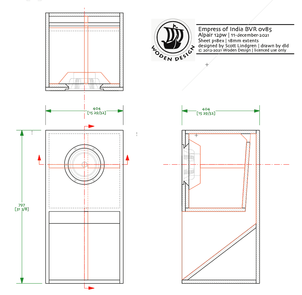

Big Vent Relex for the Mark Audio Alpair 12pw. Comment from builder (he may chip in)
Contach me or Scott about getting acess to the full planset.

I can confirm that they sound absolutely beautiful. Very very good.

Any update about sound? Natural roll off on woofer and only capacitor on tweeter something like https://totemacoustic.com/product/element-fire-v2/
You are going to have to play. I suspect that the combing issues were what moved the builder to try an upward filter where you get HF splash to brighten thhings up but interferes little with what you here directly.
Nominal 8Ω start with 2-4µF (10-5kHz). Top of the A12pw goes to about 10k on axis, less off-axis.

Hi Dave, any news on the 12p variations yet?Note: work is proceeding on an A12p variation, Ramillies, there will be a tall & a fat version.
