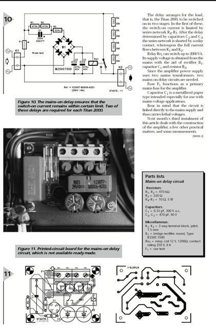

Looking at Fig 3 on the Sound West site it shows the hot active from the mains (A) connected to the relay. It also has the transformer soft active (presumably the live wire to the transformer primary) connected to the relay.
So if the mains live is connected to the relay then AC flows through it.
If the soft active (SA) is connected to the relay then AC must flow through it.
Therefore the relay must have AC flowing through it, or else how is DC generated to provide the 24V DC current to power the relay?

So, thanks to Per-Anders soft start board (which I've purchased) I now understand that another rectifier is required, along with resistors to drop the voltage, and that is where the DC is obtained to power the regulators.

If you cannot find a low voltage DC tap on that circuit, or figure out how to gen the required DC from the circuit...
External batteries or a very cheap and ubiquitous DC wall wart can provide the power to energize the relay.
Ian, the board takes it's power from the mains. Just put mains voltage into the connectors marked MAINS IN and hook up the transformer where says MAINS OUT.
If you are worried about DC into the transformer, this is nothing to worry about really. It only may be an annoying acoustical phenomina. In case you have problems, wait until you have connected the transformer. If you experience problems described here you can take a peak at my solution.
No it's not required!!! because, You already have DC for the chipamps don't you. That's the whole beauty and the simplicity behind it.
What I was describing is simply adding 3 additional parts with the relay coil going to the big caps that filter the main DC for the chipamp.

What value has the fuse you blow? 3.15AT would last for a 300 VA toroid. Can you start the transformer with anything connected with a 3.15AT? You could possibly have connected the secondaries wrong. Please take a photo of this if you can start the transformer without anything connected but not with the secondary windings connected.westers151 said:Per-Anders, it's only a chip amp with a 300VA torroid, but for some reason it blows any remotely close coupled fuses when switched on, (when it really shouldn't) hence the soft start. Also, I understand how to wire yout circuit - my question was started before I found your site, but after looking at your circuit I now understand the wiring.
As for you Infinia - you're an idiot of the highest order. What a smug attitiude you have just because you understand more than I do, yet you knew what I wanted. Why didn't you explain how the DC was generated?
Honestly this place is full of smug idiots with a "superior than thou" attitude to those of us who are trying to learn.
When you get things to work properly with my soft start you may choose 2 or 3.15 A fast fuse. The peak current with 100 ohms in series is around 3 A for 10 ms perhaps.
