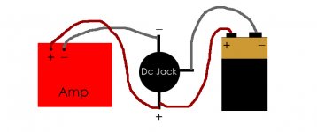

I think I got it with your help. I traced down the positive and negative pins on the jack.
1. I wired the positive and negative of the jack to the circuit board like I normally would.
2. I wired the positive of the battery to the same positive pin on the jack
3. I wired the negative of the battery to the empty pin on the jack.
So it powers on with the battery, YAY! When I plug in the wallwart plug into the jack it switches it off. YAY again! LOL
I think I got it. Just want to make sure the wiring sounds right to you guys.

If its all working it must be right... with the proviso that I would just check that the battery voltage doesn't rise when you plug the wall wart in.
If it did then it indicates the battery is being charged... which would explode... hello ! are you still there :D

Mooly, yes nothing has exploded yet, YAY!!! It sure seems right, but I am still a little nervous. Can you ease my mind by checking out the simple schematic I did.

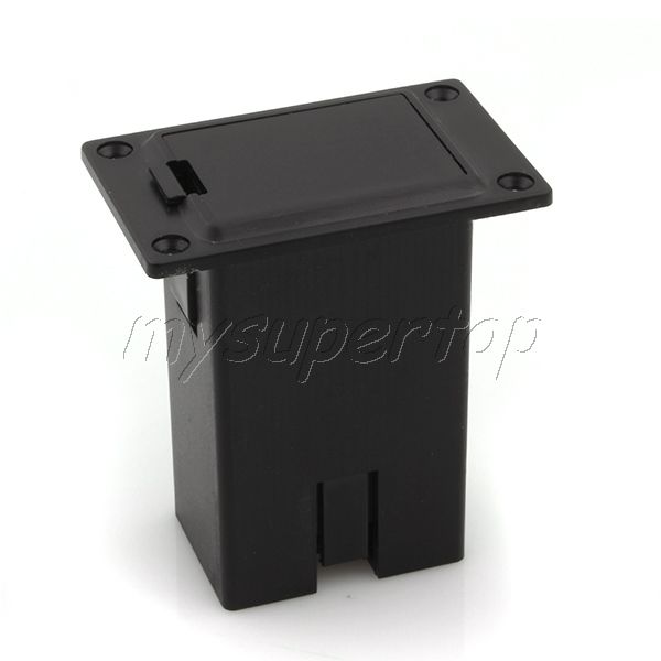

Both the fit and the weight is a huge factor for me. I play guitar, one of the acoustic/electrics uses a 9V, the battery compartment is very easy to access. It is setup like this one. I like the fact that I can cut a hole in the enclosure and mount the battery compartment on the outside and have easy access to change it out.
The downfall obviously is the battery life, however I don't stay at the beach longer then a couple of hours anyways. So a 9v would last me 2 days, when I write that it doesn't sound like much LOL.
