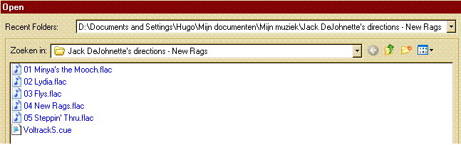

Is anyone aware of a hack to make the ‘File->Open’ dialog window display ‘Details’ by default instead of a simple ‘List’ in WinXP?

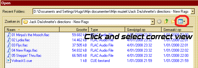

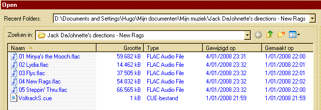

Indeed, Word remembers.
Explorer doesn't and going through the hassle each time I open a file is very annoying and time consuming.
Every program that uses the windows explorer 'File->Open interface behaves the same. Setting the view properties doesn't help either.
I was thinking of a registry tweak but until now, I haven't found it.

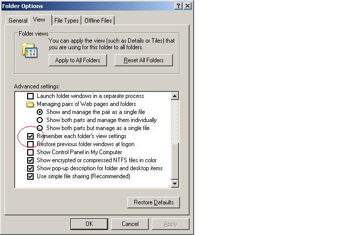

mpmarino said:
Hmm, isn't this function in 'folder options' as below:
maybe I misunderstand the issue....

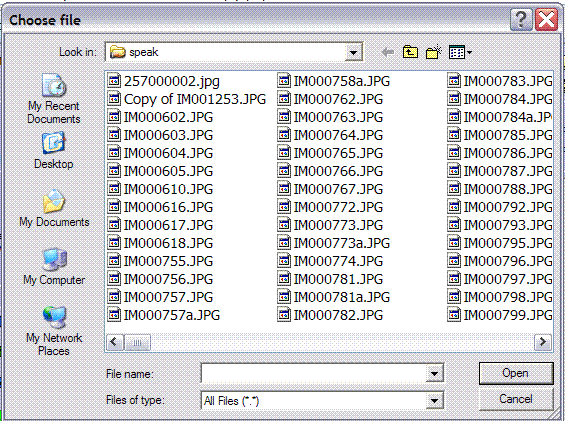

I think he's talking about the same problem I've had where the default view for my pictures folders are "thumbnails" and to select a pic to show here, it doesn't show thumbs, but uses the "list" view.
Nothing I've done has changed this. Aggravating.
