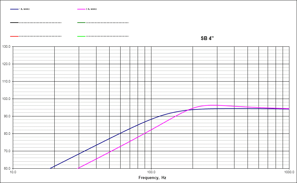

Just put the parameters of the mid driver into winisd and model it with sealed of various sizes and see what you get. If you are going to cross it over high (say 500Hz) then provided you aren't getting peaking in that range you can make the volume quite small, and you should get better power handling to boot The 5L was just an example (and is probably bigger than most ever would be).
Graph shows my SB 4" driver modeled in the "ideal" 1.5L volume and a smaller 0.5L volume. You can see the effect of the smaller volume, but if you were crossing at 500 Hz it wouldn't be much of an issue.
The power handling is where it gets interesting. with 1.5L 5W is about the maximum without exceeding xmax. With 0.5L you can put 20W into it without exceeding xmax.
Also take into account that any enclosure you add for the mid is taking away volume in your 45L main cabinet

A sealed mid compartment's job is isolation if you are crossing over several octaves higher than the resonance. (usually) Larger does not hurt performance, but it is a waste of space. So, if yo have a 4 inch mid and the T/S parameters say it has a resonance say 80, and the model says it could be tuned to an F3 of 110 Hz in 2 L, but you are going to cross it over at 500, then half a liter or 10 liters would make no difference. Go ahead. Model it. Add the filter WinISD lets you.
Yes those sealed back mid's from the 60's were crossed over pretty high. They were cheap. Yes many speakers did not isolate the midrange. They were cheap.
This not a complicated issue. Isolate your mid in a well stuffed chamber so you reduce any reflections back through the cone. That's about all there is to it.
