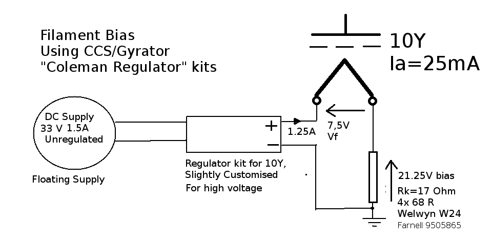

Hello Andy, always like to hear your enthusiasm for the 26 linestage!
Manu asked for a filament bias solution last week, and I'm due to test it now.
The standard regulator can be used, with a couple of signal transistors uprated for voltage durability.
Here's a sketch for Manu's 10Y stage. The voltage can be increased for solutions with supply voltages at 70V (!) or even more.
The supply is buffered from the filament on both sides, for best isolation, and the regulator works exactly as the standard version, to give the same good sound.

Thanks Andy, The LT108x regs have a current limit that goes negative-resistance on you at around 22V. With a cold filament, the load resistance is low, and oscillation is very likely. That in turn heats the chip & triggers the current-limit and/or the overtemp cutout.
I have found that the filament supplies benefit from added isolation always. I have not found where the limit to this benefit lies. Isolation transformers are worth the trouble, for instance. If you have some big chokes, they would certainly be worth trying. In this case, an added cap, near the regulator, is recommended.

Some extra fun can be had with filament bias: you can use the fine-adjust of the filament current to fine tune the DHT's cathode bias. There's a high-quality 25-turn trimmer to adjust the filament current either side of the nominal.
Should be OK to operate a 26 filament between 1.40 and 1.55V anyway, and gives some bias tuning between cathode-resistor values!

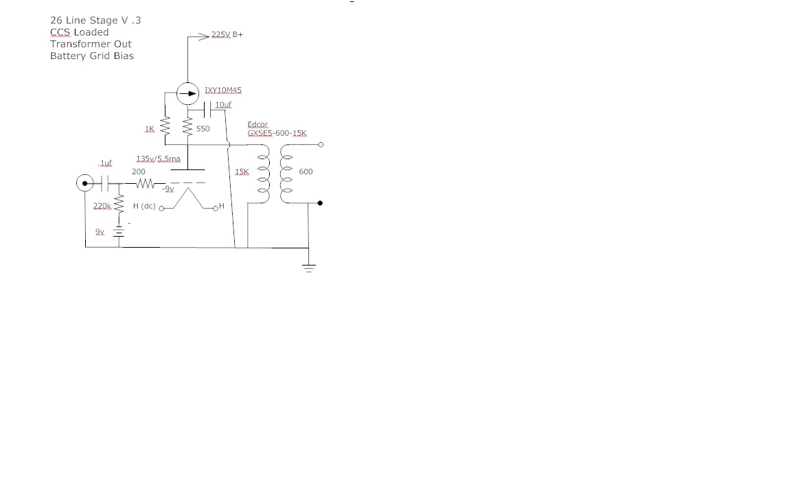

Attached is the next version. I have gone to battery bias, hopefully implemented correctly and added the 10uf to ground from the output of the ccs.

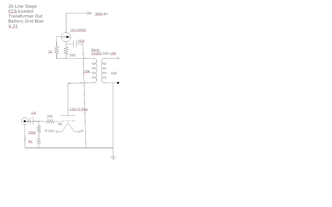

You post and George's (tubelab) post may have crossed. But anyway. Here's an intuitive way of thinking about it:
A CCS has high output impedance. Its job is to keep the current constant regardless of what voltage is across it. Basically, as the anode voltage of the tube changes, the transformer primary will "ride the wave". As the anode voltage rises, the voltage across the CCS will be reduced by a similar amount, and the voltage across the primary of the transformer hardly changes. Hence, no change in voltage on the secondary side --> no sound output.
Adding a big cap from the CCS output to ground will reduce the AC impedance at that node to zero (close to anyway). So now for AC signals, the voltage stays put and you get the full anode voltage swing developed across the primary of the transformer.
Fair enough. The idea wasn't immediately intuitive to me, but that doesn't make it wrong. In that case, I'd probably build it like a power stage. Scrap the top resistor and the CCS. Connect the tube anode to the primary of the tranny and the B+ to the other side of the primary. Voila.
Then you have to figure out how to bias the darn thing. I'll leave that as an exercise for the reader... Actually, KevinK described it well, you just need to look up the terms and figure out what he meant. That's part of the learning experience...

thanks for explanations tom. Oops I thought I was setting bias with the resister to ground at the filament! i ordered the Morgan Jones.

Move the cap to the other side of the 550 Ohm resistor.
But be aware this way it is not a CCS loaded triode any more.
The CCS only serves the putpose of good PSRR in this scheme.
Also make sure your output transformer is speced for DC in the primary.
You can achieve this also by a simple passive filtering scheme instead of a CCS, maybe better for a beginner to gather some understanding how things work.
I'd also suggest to build the circuit with an IDHT first, makes things a lot easier. For example you could use a 6J5. It can be heated with 6,3V AC.
Once the circuit works with the 6J5 you can change to 26. Both have similar plate resistances. The 6J5 has more gain though.
With this approach you can first sort out any basic issues with the circuit. When it works ok and you switch to 26 you know that any new issues are related to the DHT.
Also make sure to use a good quality transformer. In my opinion it's a waste to spend a lot of effort to deal with the diffculties of a DHT and not use adequate components. Lundahl LL1660/10mA will be an excellent choice as line output at reasonable cost.
I'd prefer an IDHT linestage with good quality transformers and good quality PSU to a DHT with cheap transformers and compromised PSU
