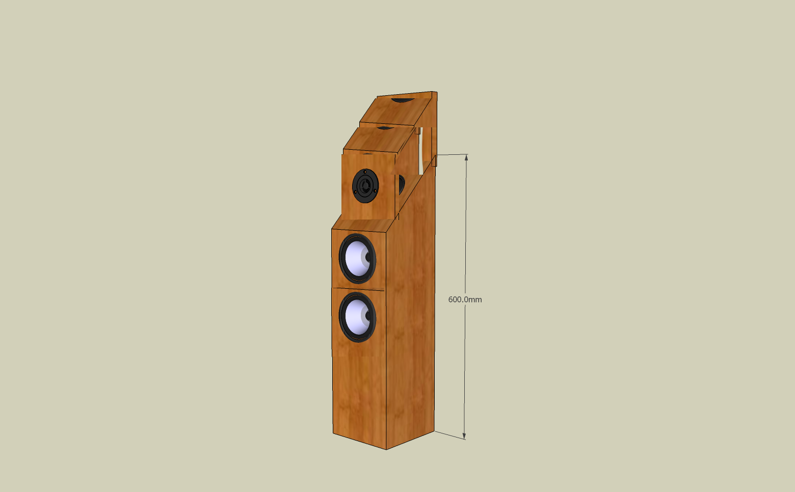

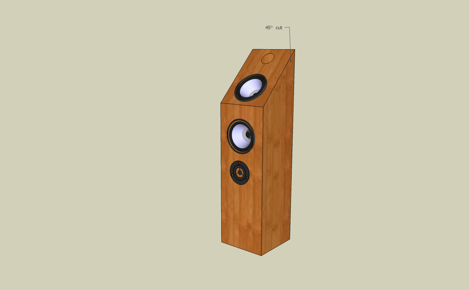

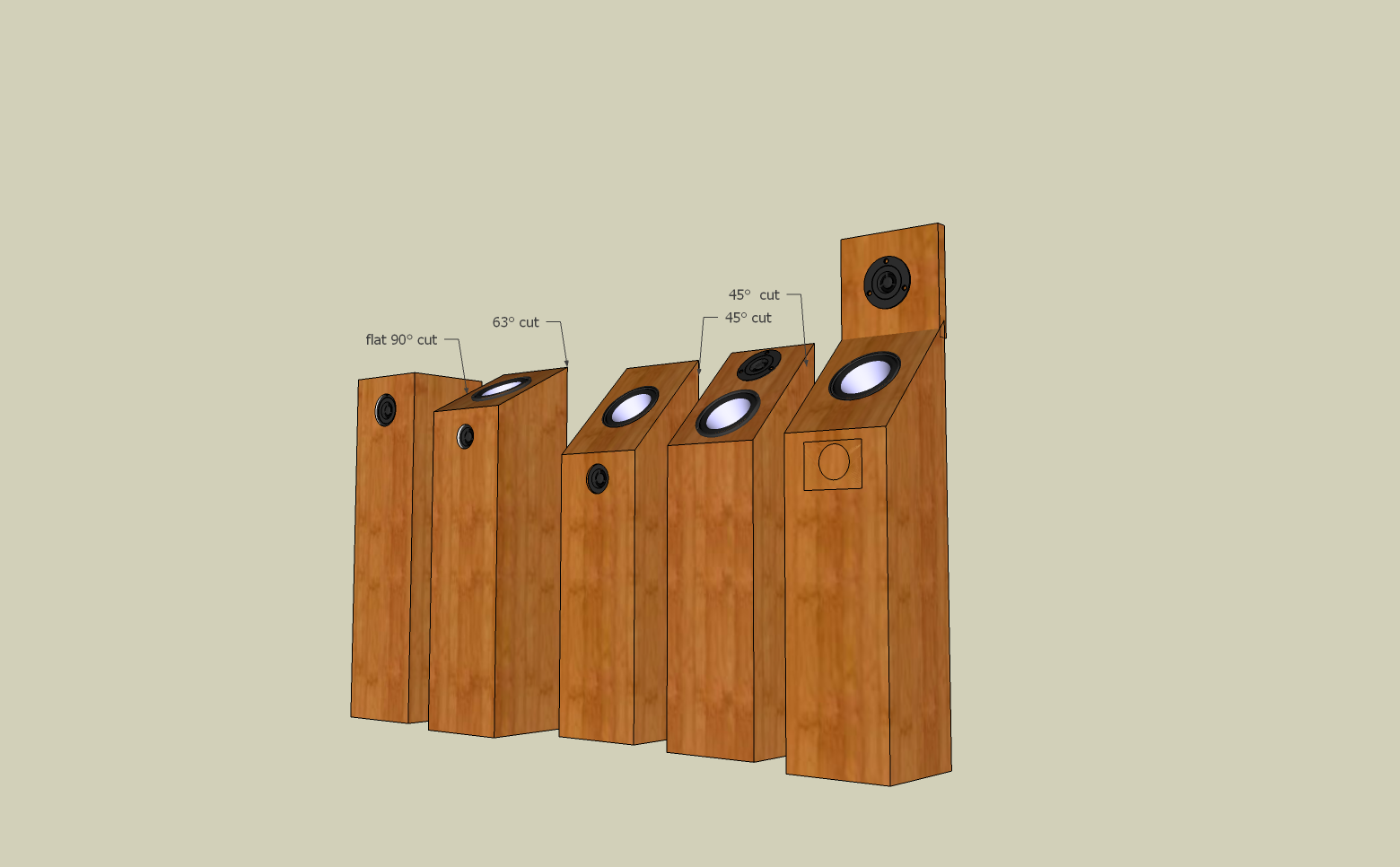

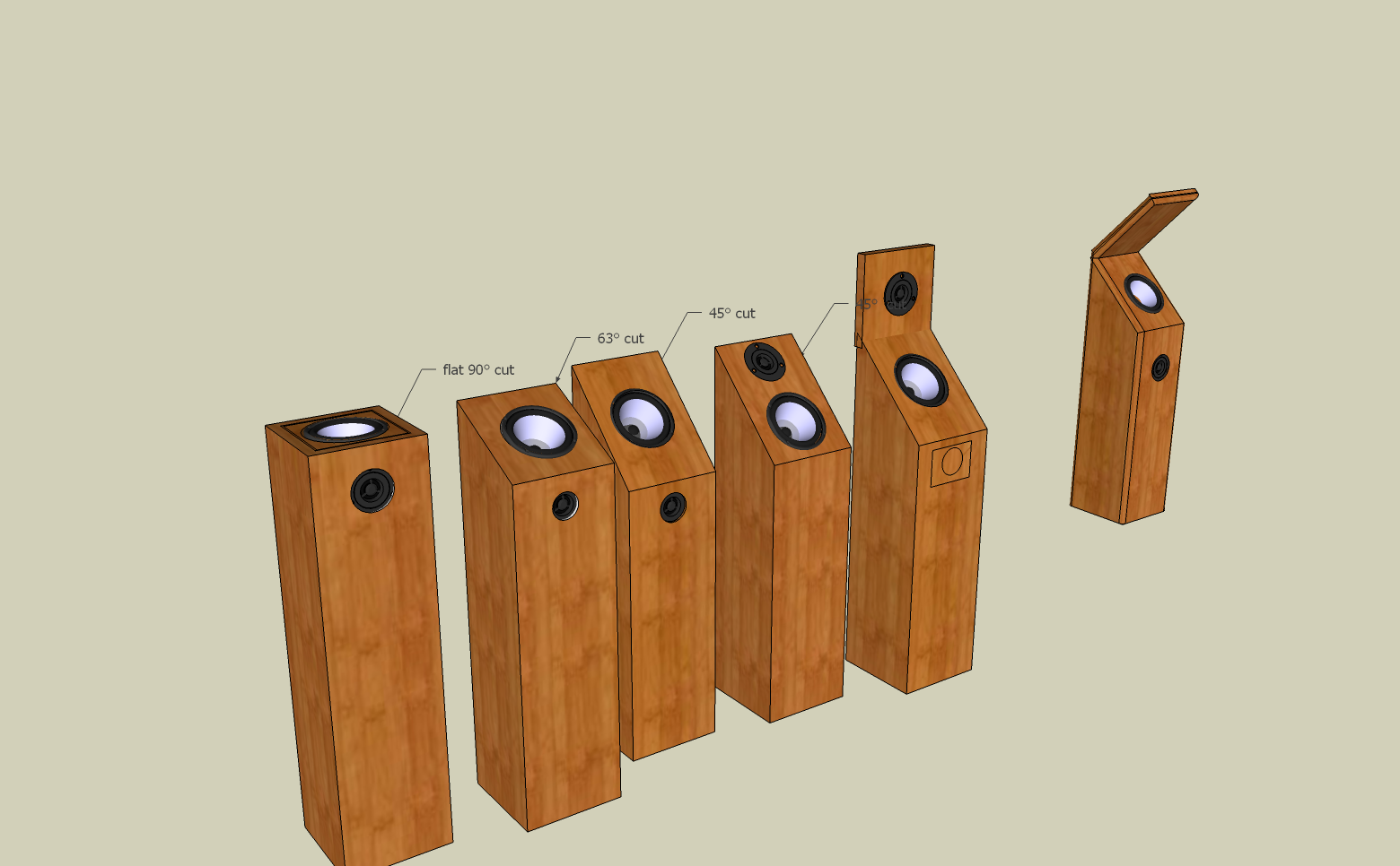

Will this design work? (Drawings)

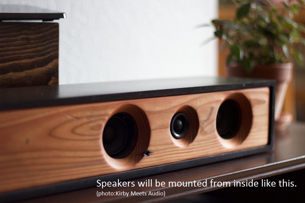

DonVK I understand now. Thanks again. so I'm up here with some new drawings. I also add my recent project, so this floor standing ones will be same type, rounded over edges and oil finish, but speakers will be mounted from inside. I have a sample photo from Kirby Meets Audio about speaker mounting.
I hope this time i got something works...

So what do you guys think about my last sketches? Will any of them worth to try?
By the way, they claimed woofers are 35w and tweeters 20w, i used 3 inches woofers on my previous project, from same brand. It's unexpectedly good. But i'm not an audio guy. Maybe it wont be pleasant for you guys.
What goals are you trying to accomplish?
Usually a tilted or horizontal woofer is attempting to make omnidirectional sound, using reflected sound off the walls. However you need room to do this, as the speakers cannot be against a wall. Is your listening space large enough to put the speakers >1m from any walls?

This is only a suggestion, I have not made a speaker like this.
Try a type of vertical "bipole" which are made to be mounted against walls. Top woofer or full range is on surface between 30-45deg down from horizontal making the angle from the vertical wall 120-135deg (oblique). Then either a woofer or full range driver on the front surface equi-distant from the front edge with top driver. Then a tweeter, only if the other drivers are woofers. If you use full range drivers you don't need a cross over, and you can go a little bigger (5-6inch) driver for similar cost. Also, if there are children around you'll need a wire mesh driver cover otherwise they will poke the drivers :)
Do you mean like this? I will need larger space for this am i right? I mean i calculate the chamber that speaker stay is about 5,6 litre exactly what manufacturer recommend. If I add one more speaker do I need double space?
I agree with Scott, the tweeter needs to be roughly at ear listening level.
Yes, 2x drivers means 2x volume but you'll also get much better bass from small speakers.
I can't tell how high the cabinet is. One drawing has a vertical tab at the back (oblique to top woofer) of the cabinet for a tweeter. That would be one location because it would be parallel to the wall and raised to ear listening level. However it does cause a phase shift problem from the woofer. Another solution is to put the tweeter as high up on the front surface so its aligned to the front woofer.
Are you sure you don't want to use 2 full range speakers for this, and avoid the other issues?

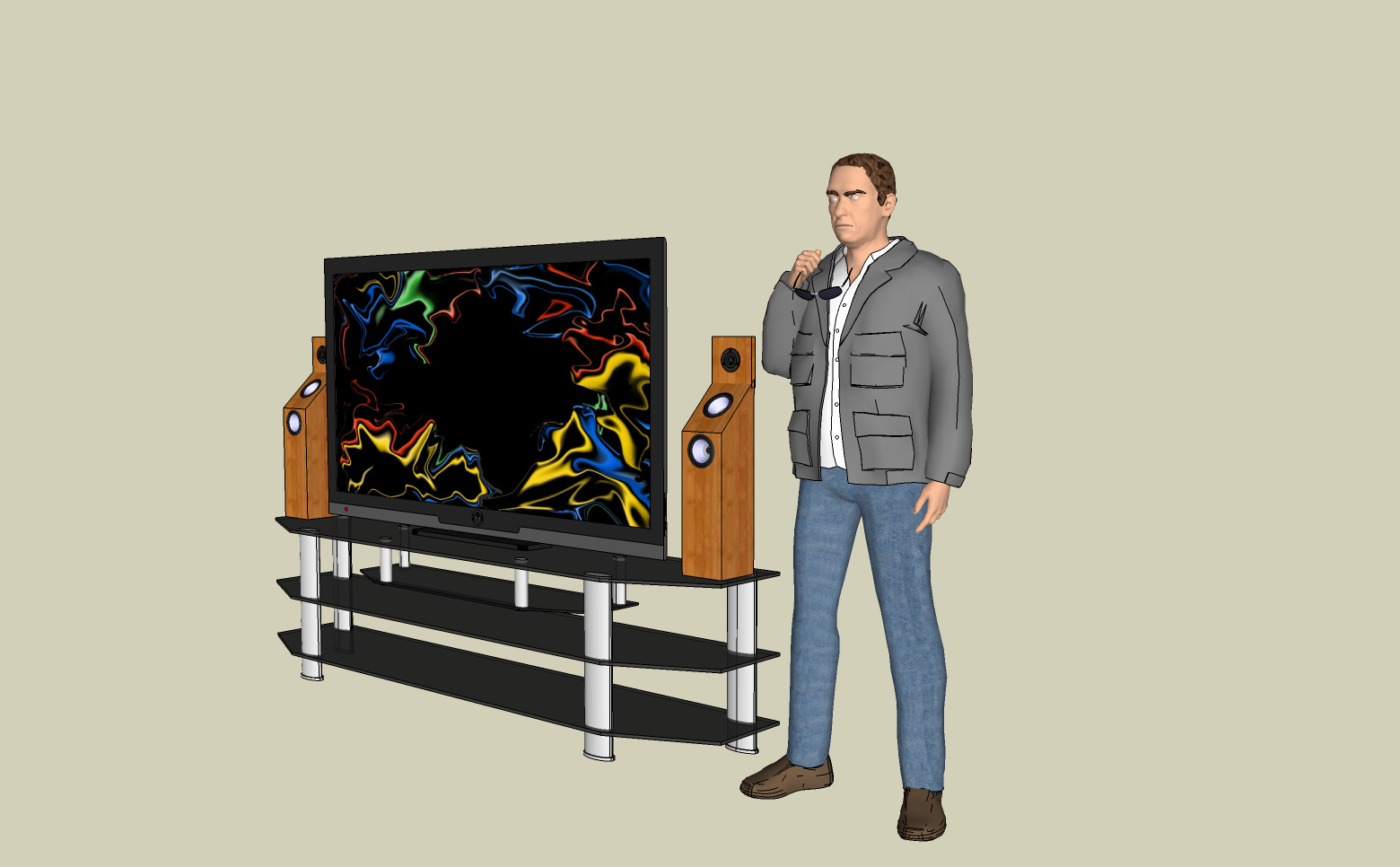

I really appreciate guys, you already taught me a lot. So, what about this drawing?
And I want to ask should I double the cabinet volume due to 2 speakers?
Speaker itself about 60cm without that tweeter board. I thought it can be even place on the TV stand. The guy in the drawings is about 180cm tall. He can give some idea about scale.

If you bring your tweeter plate down to where the bottom of the angled woofer is and put the other woofer underneath the one on the base you would have a TMM style with the tweeter being reasonably time aligned. Much more conventional but likely to be more successful.
By combining radiation in different directions from the same type of drivers will create interference patterns. This can be helpful if you know what you are doing and can control the relative levels or EQ of the drivers like the Beolab does.
In your picture it is more likely to create destructive interference and peaks and dips in the response.
Cabinet volume is dependant on the parameters of your drivers, do you have any Thiele Small parameters for them. Also whether it will be sealed or vented.

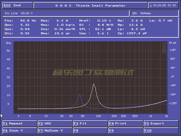

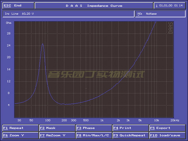

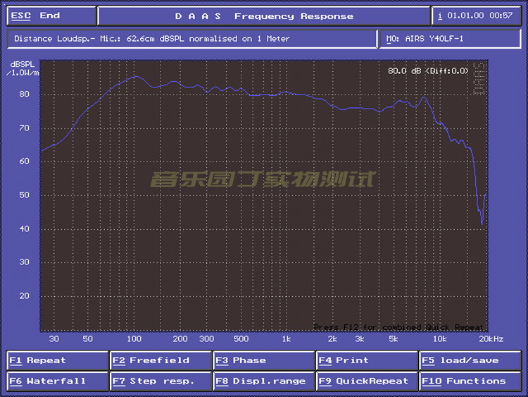

I attached the graphs that manufacturer provided. and the other informations are like this;
Rated power: 35W
Maximum power: 50W
Peak power: 100W
Effective frequency: 75Hz-5500Hz
Sensitivity: 86dB
Qts: 0.56
Cabinet volume: 5.6L
I designed as sealed. No any reason just easier. I think vent hole and insert pipe also need some calculation. I feel very down now. I think it will ended up ordinary book shelf speakers; woofer and tweeter in the front. :( :( But I want to make something visually different and pleasing.
Rated power: 35W
Maximum power: 50W
Peak power: 100W
Sensitivity: 86dB
Qts: 0.56
The last page is the most useful as it lists the T/S parameters put these into a box program and it will tell you the optimum cabinet volume.
There are some strange things in that Qts is shown in the image as 0.52 and not 0.56, but Vas at 5.6L is the same as the cabinet volume they have listed.
Making the cabinet the same size as Vas will work but it may not be optimal.
Sealed is fine but those woofers won't go very low in a sealed cabinet.
