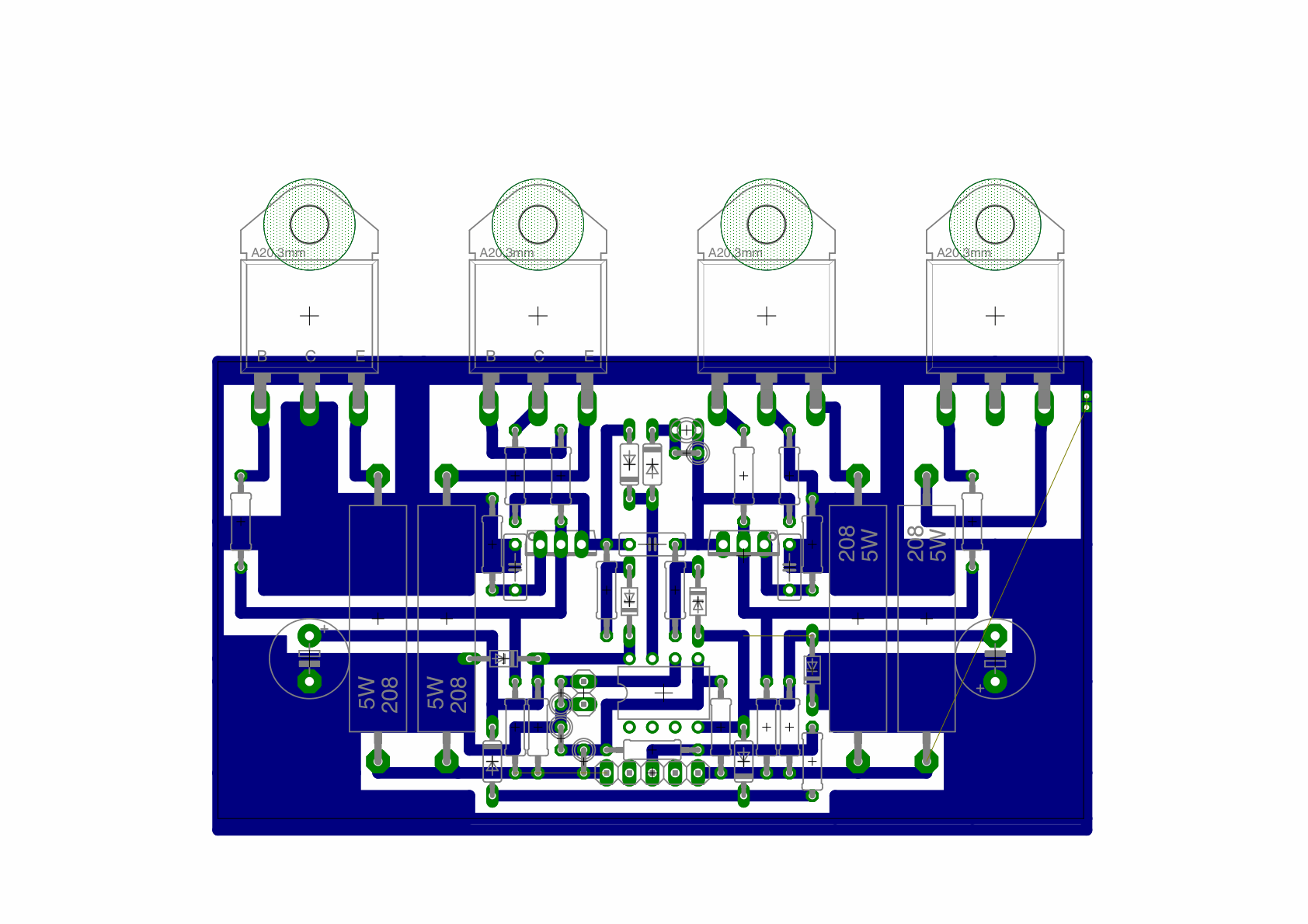

i just designed a singlesided pcb. is it ok? i'm not really good at designing pcbs...
Copying QSC is easy , but you forget to place collector to rail resistor at both driver transistor collectors.
