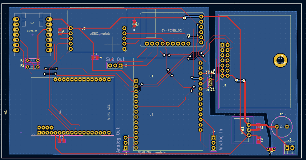

The fact that the A31 is shipped as a slave device simply means you must provide a bit clock and LR clock. Those clocks are usually generated by the ADC chip (or the MVSilicon SOC chips that include analog inputs). You could also generate the bit clocks and LR clock using one of the ESP32C3 boards, which have I2S I/O. I made a board with the A31, an ASRC board, ESP32C3, ADAU1701 module and a 4-channel amp board as phase 1 of a larger project (line array amp). I've got the boards and all of the parts but found out I screwed up the A31 footprint by using .1" pin spacing rather than 2mm spacing (I corrected that error in the picture below). So, I need to test this board with a Dayton WBA51 module. I should be able to debug that circuitry over the next month. The amp board, on the right, is what might take the most time.
Phase 2 will use the A98, along with the ADAU1466. This is done in Kicad and files will be available.

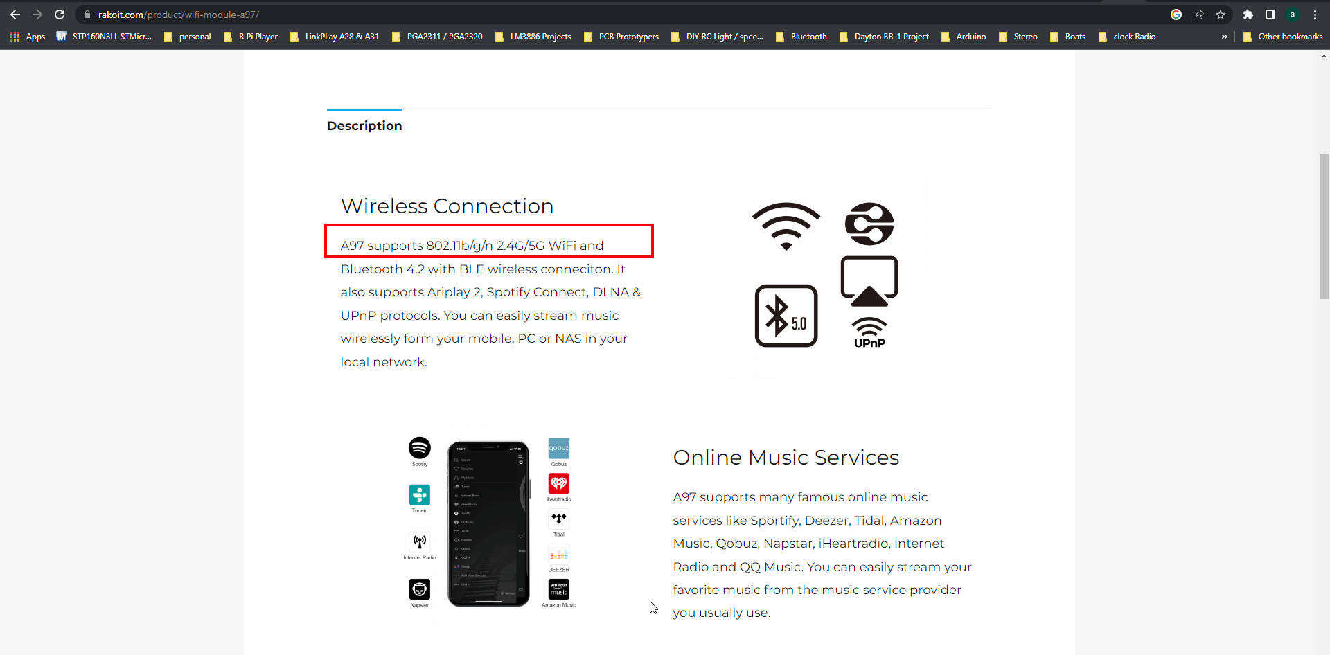

@Neil Davis i corrected my post that Linkplay site does not show but the Rakoit site shows it supports 5ghz.
But if we do Linkplay A97 FFC, there are some places it says 5ghz so not sure why Linkplay would not update its page.

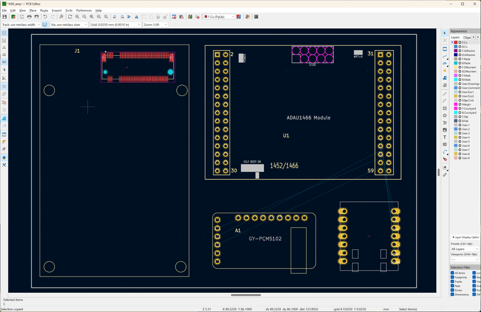

I decided instead to make a board using the ADAU1466 "Core Board" with the Linkplay A98. It's just a "test bed" board to verify that the PCB footprints are correct and to get a start on the code. I'm just starting the layout, but it should go quick since there aren't too many connections that I need. If I can make some progress with this, I'll shoot for a real design with SSM3582 amps that would make a nice WiFi speaker.

There is a page describing the several prototype boards alluded to in this thread at: http://www.audiodevelopers.com/next-generation-evaluation-boards/
The discussion of where this is heading next is here: http://www.audiodevelopers.com/next-generation-beyond-the-adau1701/
