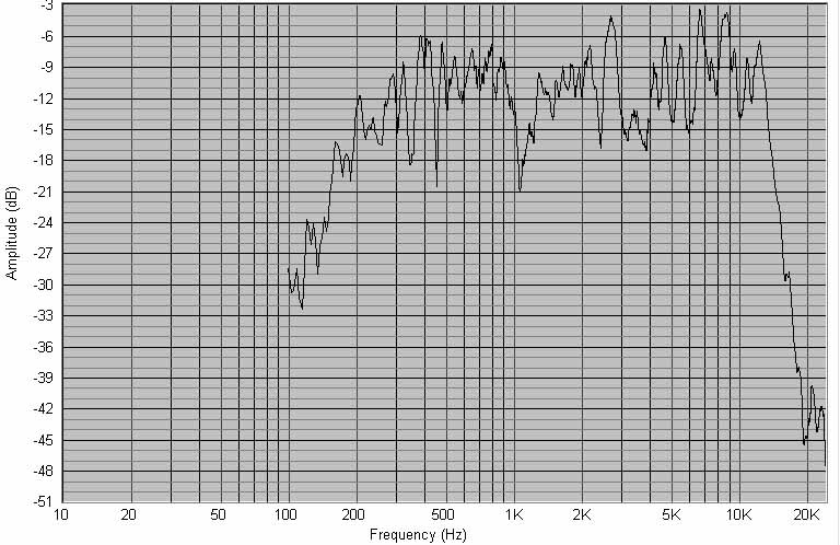

that's pretty durn close for a wild stab _grin_
Not sure of the technical cutoff but it starts dropping down pretty good about 125 hz -
I'm crossing over with a digital crossover at 134 hz 4th order to the subs
I've attached a jpeg where John Sheerin measured Jeffrey J's Azuras with DX4's that indicates you are very close with your calculations.
This chart also has had me thinking that eventually I may use the digital crossover only on the subs, and try the acoustic cut-off of the Azuras with the DX4's. However, when I tried that earlier with the Fostex FE206E's there was cone breakup distortion on orchestral crescendos - might be better with the DX4's and when I put the DDS waveguides on top with a passive crossover there.
My gameplan is to have the dispersion characteristics of the system match throughout the bandwith as much as possible. I have a pair of DDS ENG 1-90 pro 1" waveguides with Radian 475PB drivers. I chose the waveguides because they had the widest dispersion of any round horns I could find.
My initial target for passive crossover point to the dds horns is about 1250 hz or so. The reason I chose that point is because the Azuras are out of horn loading about 1500 hz and the ENG 1-90's load down to around 1000 hz,and because most vocal fundamentals are beneath that point.
I've got so much going on that it's hard to get time to fool around with it _grin_
It was encouraging to see Weltersys comments to Duke in HE about using cones for the 100/200 to 1000/2000 decade. While I was already embarked on that path, it makes me eager to get moving on it _bigger grin_
Regards
Ken L
Tim Moorman said:Ken,
According to my calculations, your horn may load to around 250 Hz with something close to 178 Hz cut-off? Just a wild stab.
What is the supposed cut-off?
Tim

It wouldn't take the .jpg due to forum restrictions on size so I resized it down.
Ken L said:I've attached a jpeg where John Sheerin measured Jeffrey J's Azuras with DX4's that indicates you are very close with your calculations.
