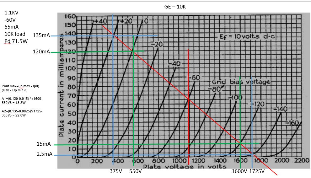

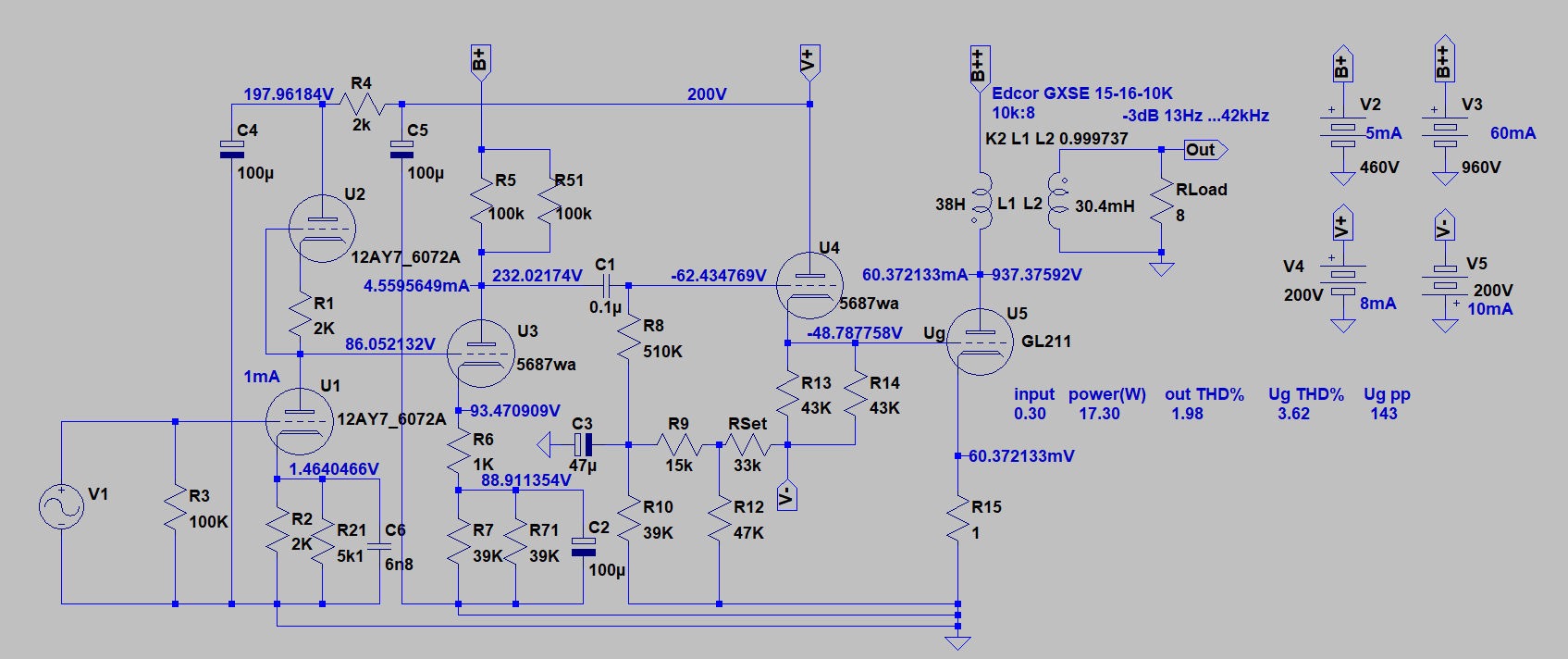

Assumed, that other voltages are the same as in you picture (AN version of Ongaku).
If your goal is 60mA anode current of 211, must to set grid voltage (setting it with Rset in my schematic) to about -50V (see datasheet).
As you can see, even 1100V, 65mA, -60V is correct operating point for 211.
Sample schematic, B+:960V, Ia:60mA:
Joined 2004
Try to measure 211 anode voltage, cathode current and grid voltage (bias) in working monoblock.
It may be near as in my sample schematic.
If the bias (grid)voltage isn't correct, the anode voltage is lower than expected and cathode current is high.
BTW Ongaku style PSU (if you use 5AR4 tubes and about 100R DCR/secondary part PT) without load (no working 211) produces 1058V.
If any capacitor damaging in this PSU, the doubler not working, so output (HT voltage) collapsing.
