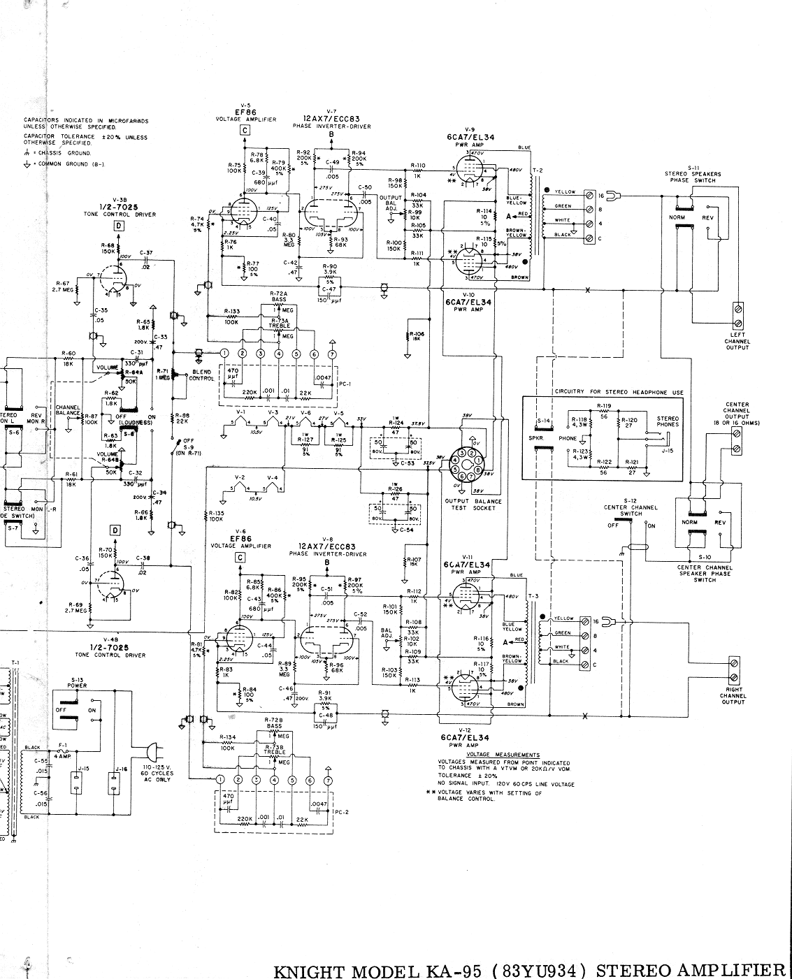

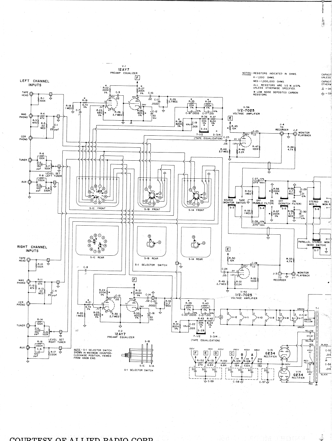

Why two GZ34 in this schematic?
Here is a schematic from an amplifier that I own. It is a Knight KA95 integrated EL34 PP. I am trying to educate myself about power supplies. Why were two rectifier tubes used like this? Correct me if I'm wrong (which is entirely possible) -- the diodes from each tube are simply paralleled and it is a conventional full wave rectifier, right? It appears that other EL34 based PP amps usually get away with a single tube for a full wave. Did the added load of the preamp circuitry necessitate this arrangement?
Thanks,
Michael
PS -- the PS is in part 2 of the schematic.

Probably down to the amplifier power output rating and the additional circuitry. Stereo amps like the ST-70 just squeaked by with a single 5AR4. Pairs were sometimes used in higher power amplifiers where more than 250mA was needed, and relatively low forward drop (for a tube) along with reasonably good regulation was also wanted.
