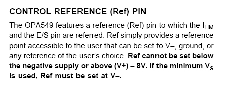

why o why doesn't this work ? Balanced 549
I tried this idea to drive the balanced output of my Roland E660 in a gainclone. Used chips are OPA549. No bad smell, no DC on the output but also no sound :confused: They are powered with 2 12v batteries wich gives a -12 and +12 rail. Also there's a 0,1 µF cap over the 2 rails.
Even when i connect just one on a unbalanced output still nothing.
The only thing i hear is a slight *pop* in the speakers when I power the 549's.
I just red the datasheet over again, in wich stated that ref. pin must be als low as the negative voltage if V- is used. So in my case -12. Sadly enough I don't have anymore samples avaible so this project has to wait.

oops, sorry. i forgot that they go to -v. :xeye:
