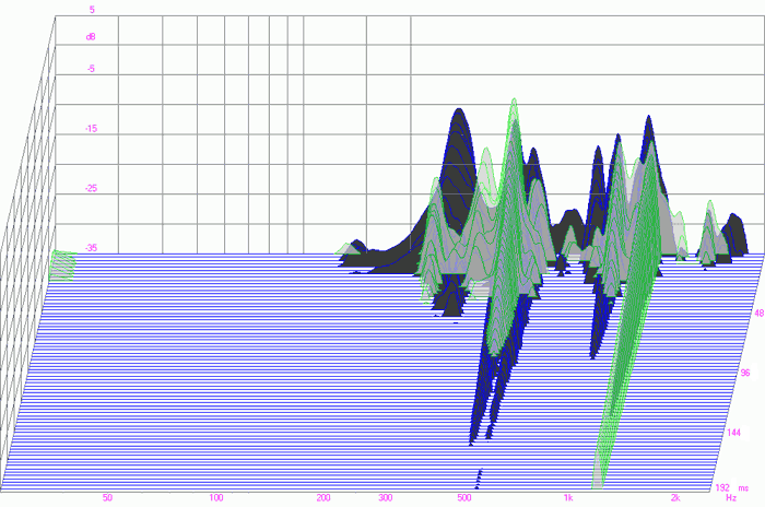

MJL21193 said:You have yet to provide any proof of this being the case.
And you have provided none that says it isn't so. The chart i posted is certainly indicative,,, unfortunately it doesn't reach down to where the meat of the phenomenom is...30-50 dB down.

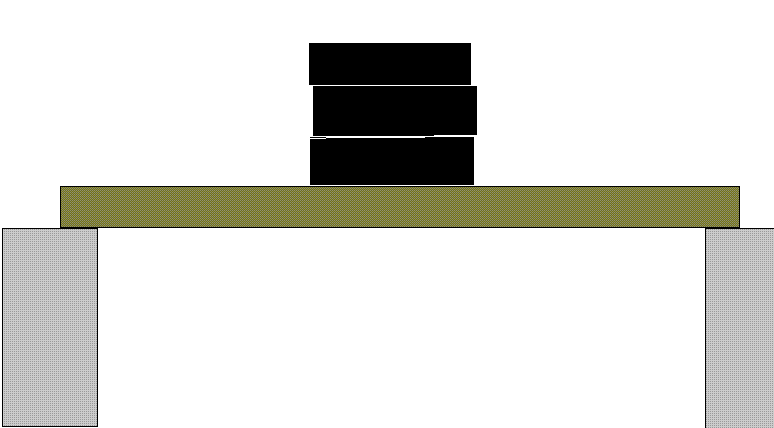

...that you can worth with MDF in such a way at to push the panel's natural resonance upward, above the cabinet's passband (as is usually done with ply), rather than downward, as is more usually done (if it is). My only concern with that would be because MDF is inherently less stiff as a material, the structure will be much weaker unless a huge amount of bracing is used.
I know that MDF is less elastic than plywood, but I'm not so sure about the stiffness, especially with the panel sizes used for the average speaker.
One way to find out (if this info is not readily available) is to conduct a deflection test. A piece of MDF and a piece of plywood, same thickness (say 1/2"), same size (say 5" x 20"). Place these strips with their ends supported, put weight on the centre and measure how much each deflects.
I have drawn a crude illustration of what I mean below.
Anyone volunteers? Or should I do that too?
PS. I've been in construction for most of my life, both residential and big-buck commercial. A well built speaker cabinet, even made from MDF, is one of the strongest structures I've seen.
