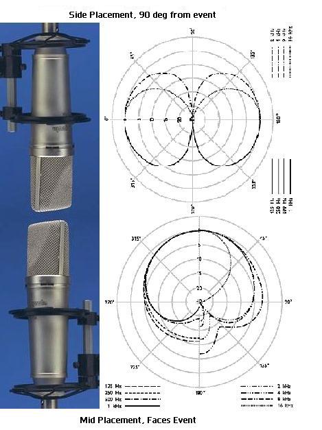

I always thought that M-S was the generic implementation of Blumlein...
M-S, when used with the traditional arrangement of a cardiod mid capsule and figure-8 side, essentially gives you an X-Y pattern (called a 'virtual pair') The advantage is that by ajusting the balance between the mid and side channels, you are able to change the angle of the two 'virtual pair' capsules to your taste without having to move the microphones or capsules. Pretty cool :cool:

MMM... Much More M-S
In order to better describe M-S techniques, I whacked this together from a handful of images harvested from the web.
While some use a matrix to capture a fixed stereo image during recording, it is often preferable to record the discreet signals and to recover the stereo image after the performance.
Whether done through a matrix or on mix platform the recovery process is essentially the same.
The output of the side signal microphone (figure 8 pattern), is doubled and sent to two channels. One of the channels is phase inverted. The channels are panned left and right.
The mid signal (cardiod pattern) is sent to a third channel. By adjusting the pan and level of this channel with respect to the two side channels an accurate stereo image of the original event can be recreated while allowing for additional control of the apparent sizes and proximities within the image.
Kind of the way FM and MTS matrix signals work too (L+R, L-R).
Some of the magic and appeal for this technique comes from the tight proximity of the two microphone capsules. The closeness minimizes phase colorations caused by the time difference of the same wave reaching both capsules. It can be argued that M-S with Schoeps capsules (much smaller), will further enhance this effect.
Anyone notice that the outer ears are removable on the "little head"? It used to be that you could get castings of your own or a famous persons ears made to use with the head. It also allows for left and right outer ears to be interchanged if the head is used in an inverted position.
I learned a lot of this stuff from pestering Dave Moulton after he made the mistake of letting me into his acoustics class. He's written a good book on the subject: http://www.moultonlabs.com/
