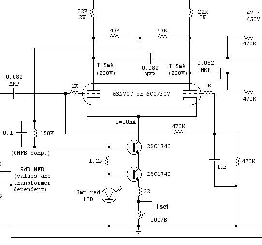

Auto balancing LTP:
http://dogstar.dantimax.dk/tubestuf/driver02.htm
My SS CCS equivalent attached.
The imbalance was 5V @ 60V P-P swing without common-mode FB, only 20mV @ 60V P-P swing with :)
Cheers!
SY said:
The quote from MJ did not, I think, refer to an LTP with a current source as the tail.
Morgan Jones was referring to LTPs with passive tail loads. The tip-off is the mention of imbalance. VTs are naturally low gain devices. After all, the u's (highest possible theoretical voltage gain) maxes out at 100 for small signal triodes, and doesn't get above 200 even for RF "zero bias" triode finals. Even high gain small signal pentodes have g(m)'s that are pretty low: 12mA/V (12BY7A), 16mA/V (6EW6) and so forth. The g(m)'s of BJTs are limited by how much current you can force through the device before the silicon die melts. Even running at a very modest Ie= 1.0mA, the BJT has a g(m)= 38.46mA/V. How many VTs have g(m)'s that high?
With very limited device gain available, you aren't going to be getting good performance from passively loaded LTPs. You can force output balance by using unequal plate resistors as a "hack". The CMRRs remain relatively poor, and if that's all you had, you'd've been better off with a cathodyne, by far.

Afterthought: if you have a CCS in the tail of an LTP, there is no need to worry about the mu in each half being different. AC balance is assured, as long as the plate loads are identical. All you have to do is make sure the quiescent current through each triode is the same, which you can correct with resistors in the cathodes.
