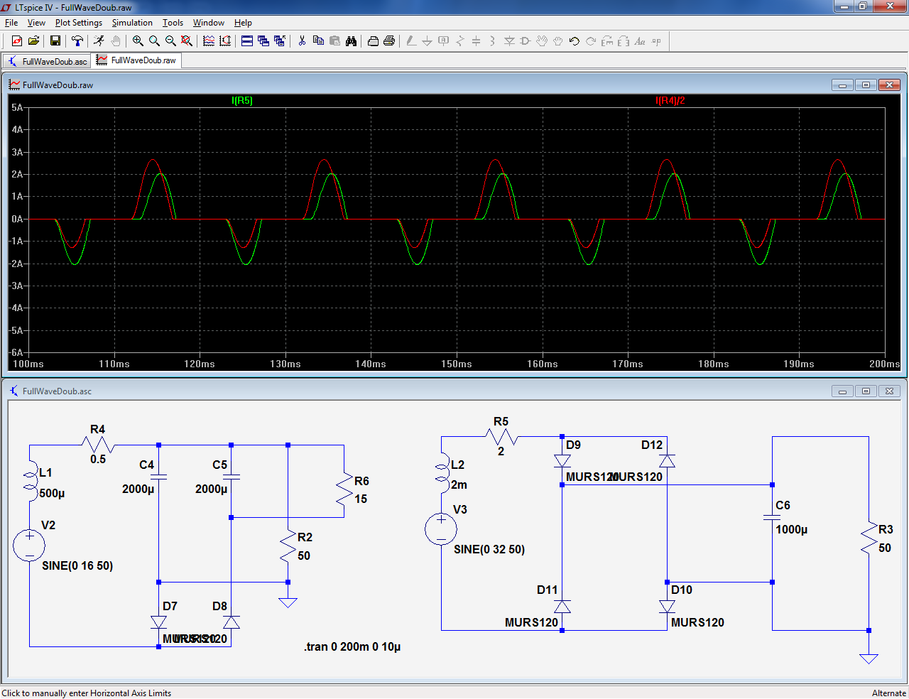

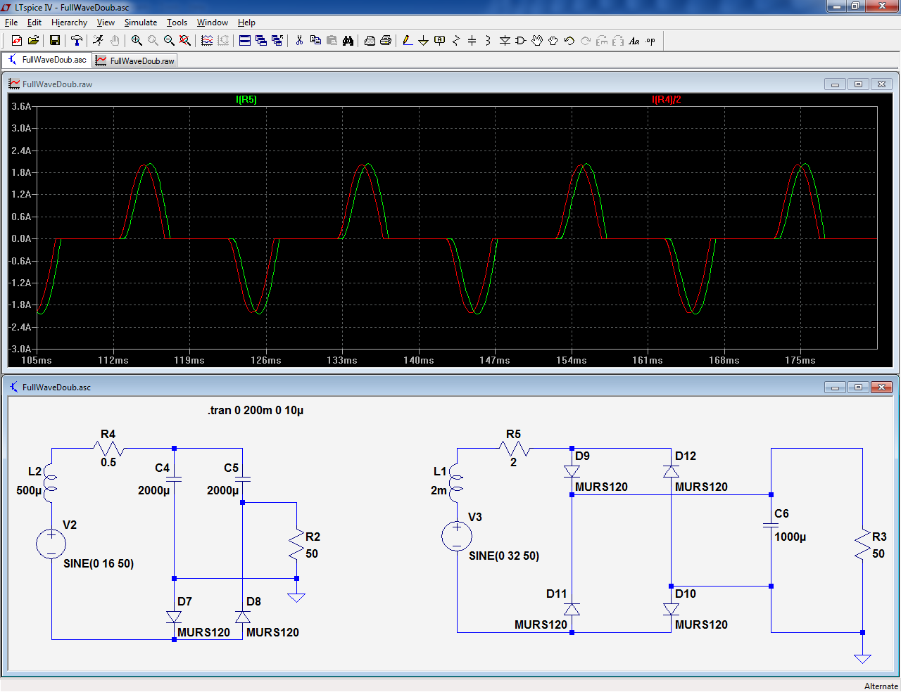

A doubler conducts twice/cycle, just like a rectifier bridge.
The transformer's peak current and utilization is mostly unaffected, as shows this simmed example.
The parameters and values have been scaled to allow for a fair comparison between the two solutions:
This is the perfectly balanced case E.g. simplified model with a single load. Compare the worst cases, with unbalanced dual loads.

Unbalanced loads will of course subject the transformer to DC current, which is not advisable, but the peak currents remain exactly as expected.This is the perfectly balanced case E.g. simplified model with a single load. Compare the worst cases, with unbalanced dual loads.
This scheme is obviously not usable for asymetric loads, but it still covers a good number of real-life situations
