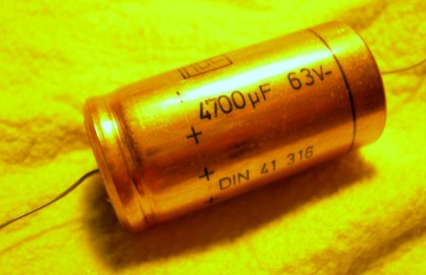

There was a sale out of axial ROE ( Roderstein ) 4.700uF/63V caps.
So I bought 50 of those.
That box of good caps has supplied my projects last couple of years.
See attached picture.
So, the 2 amplifiers are fead from those rectifiers+filter caps.
Each amp channel having its own separate power supply.
Only share the transformer.

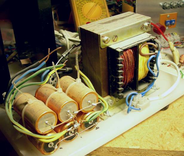

here you can see how I
have created a current supply of parallelled caps
3+3 x 4700uF for +Volt and -Volt
The biggy old E-type transformer, probably a surplus buy,
I did adjust for my wanted voltage
by rewind secondary part of it.
Thick trafo wire ( 2 mm diameter, I think )
Fresh photo of the day,
with lots of dust :whazzat: on my gear, here:
I second this approach as excellent value for money.
One achieves most of the benefits of monoblocking and few of the downsides from the shared Vrails.
