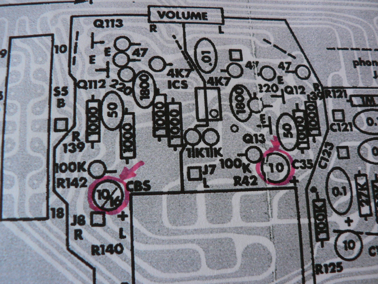

Question concerning C35 (left channel) and its counterpart C135 or CBS:
are both exactly the same type of cap (both polar electrolytics, no difference)?
The schematic says C35 and C135, the board layout (service manual) has them as "C35" (left) and "CBS" in the right channel, volume section.
And: in my APT C35 is the standard grey ICC type and the one called CBS is a blue cap (all seems to be original).
Any ideas?
Thanks,
Marc

If someone else had the same question: I have replaced both caps with Elna Silmic II and it works great.
