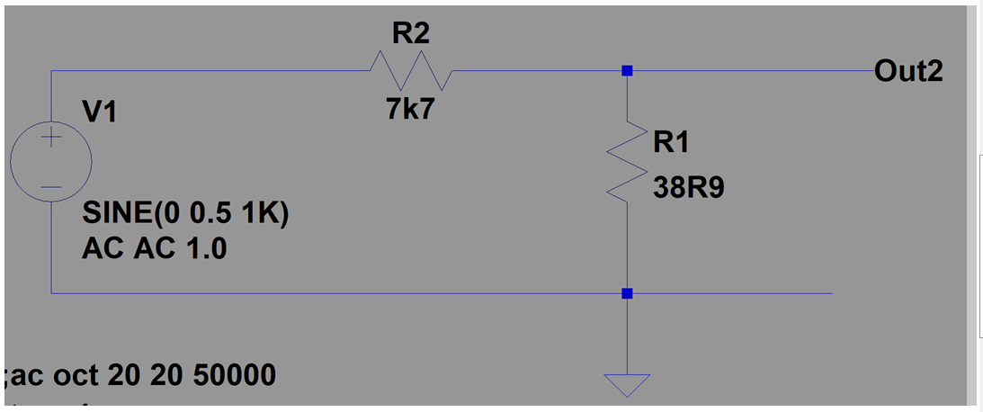

I have just constructed a precisely 40dB (1/100) attenuation circuit – in order to help me accurately set the gain of some phono products I build.
I set up a simple resistive bridge circuit in LTspice and, playing with different numbers, found that a 7K7 resistor sitting on top of a 38R9 resistor - with the signal output taken from the top of the 38R9 resistor - produced 5mV out, from 500mV in.
After I'd built it - using my CRO to measure the result - I expected to find 80mV out (on the CRO screen) from 8v in. However, in the real world – I measured only about 40mV out!!??
After a bit of experimenting, I was able to achieve 80mV out … by putting 2x 12k resistors in parallel with the 7K7 value (which was actually 2x 15K resistors in parallel).
Although I've achieved my aim of building a 1/100 attenuator, I'm wondering why the LTspice circuit gave me the wrong result! Any suggestions?

Would you post a screen shot of your simulation schematic and results?
Tom
Thanks, Tom - here it is:
I'm afraid I can't post the result - as I didn't take a photo of my CRO screen.
A 7k7 upper arm and 38R9 lower arm resistor won't give 100:1 attenuation, more like 200:1.
Yes, your maths makes sense - and, as I said, I measured 40mV on the CRO screen!
With your two 12k in parallel with 7k7 that'll make ~3k4 which would be much closer to 100:1.
Absolutely ... again the maths makes sense.

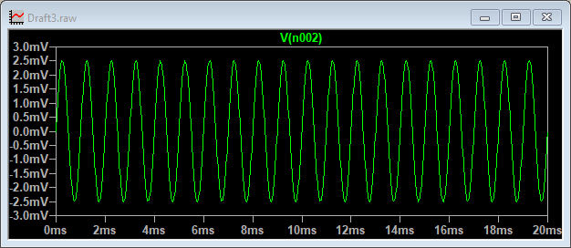

How did you measure the attenuation in LTSpice?
I used this command:
... which produced an output sine wave and I could see the +/- limits on the graph ... which were 2.5mV
Perhaps DC as input - it's going to attenuate the same - would simplify? Just put a DC probe on the output node.a 1/100 attenuator
You can put 100V in to - hopefully - read 1V out - the resistors in a simulation dont care about power dissipation.
That's just to sanity check the particular resistor pair you chose. Then you can go back to AC as the source, then back to 8V - all should follow suit.
Strange - when I run an AC analysis it doesn't show any time domain waveform, rather a FR response plot. The only way I know to get a sinewave shown is to use a .tran analysis. If the text you've pasted is actually what's in your LTSpice schematic then that's not the active analysis as it has a ';' which turns it into a comment rather than a command. Perhaps your active analysis is actually a .tran - look for a command starting with a '.' (dot).

The real command used is this:
I put your schematic into my LTS and I got the following waveform, with the stimulus voltage source 0.5V peak :
That's showing 200:1 attenuation.

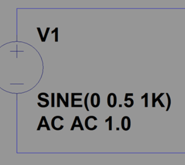

Sorry, maybe I have misread the LTspice command, @abraxalito ?
I used this:
I assumed this input would be 500mV peak-to-peak?
Hence, I expected to see - and I got - in LTspice exactly the graph you displayed (5mV peak to peak).
Are you saying that the above SINE parameters in LTspice ... actually deliver a peak voltage of 0.5v - so a peak-to-peak voltage of 2x 0.5v?
I used this:

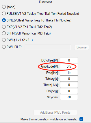

Ah, that's the nub of the problem I think. Here is the pane for setting the parameters of V1 (stimulus source) :I assumed this input would be 500mV peak-to-peak?
Yep. That's what 'amplitude' means here. Peak to peak is different.Are you saying that the above SINE parameters in LTspice ... actually deliver a peak voltage of 0.5v - so a peak-to-peak voltage of 2x 0.5v?
Thank you so much, a!
For a sine wave signal with no DC component:
peak = amplitude
peak-to-peak = 2 * amplitude
rms = amplitude / √2
Understood. Thanks, Mark.
