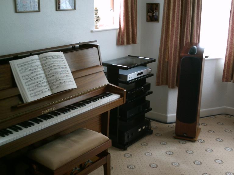

Christer said:As for instruments, I seem to be very sensitive to the difference between real pianos and digital ones. If the piano sounds digital from the start, then how could I judge if it sounds realistic in a reproduction? OTOH, a grand piano usually does sound lika a grand piano even in old recordings with a lot of noise and distorsion.
Couldn't resist this one The ultimate reference available for immediate comparison. Yes Yes Yes I know it's not a grand piano
If I understand double pole comp correctly then all it achieves is slightly more feedback over a narrow range of frequency.sreten said:....Double pole compensation .... for class A ? ....
I believe that in return for this increase in feedback that some instability concerns become more problematic, at least for the less skilled.
Oh, I am sure it sounds like a piano should. They are still allowed to have different character as long as they sound like a piano.
