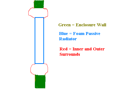

I think that mine were wiggling before they got to 15mm - but they were only about 6" diameter. As you say, you might avoid the problem with enough radiators. I guess you're going to have to suck it and see.
Mind you, it's not so difficult to make a dual surround radiator. You could use 1" MDF and cut a hole in it for the radiator - which would also need to be 1" thick. I used expanded polystyrene for lightness, covered it with paper and then doped it. You then put one rubber surround on the inside and the other on the outside.

pinkmouse said:I once made a PR from a piece of honeycomb style ply and an 18" pushbike tyre innertube, it was not a great success because of limited excursion, but it was great fun seeing how the response changed with the air pressure in the tube!

thats awesome !! I had the same idea but never built it.. I was thining about an iner tube from a wheelbarrow as it would be about an 8"diameter, but have a masive surround. I never could think of any method to mount the tube to anything other than adhesives which I didn't think would hold together. If you dont mind me asking, how did you mon the inner tube on both sides?
I was thinkn gopf this more along the lines of a super high excursion driver than a passive radiator.. but its the same general idea.

Jared said:thats awesome !! I had the same idea but never built it.. I was thining about an iner tube from a wheelbarrow as it would be about an 8"diameter, but have a masive surround. I never could think of any method to mount the tube to anything other than adhesives which I didn't think would hold together. If you dont mind me asking, how did you mon the inner tube on both sides?
Hi Jared
I stapled and contact cemented strips of rubber from another cut up innertube to the "cone" and the mounting, and when they had set properly I pushed the three parts together, and used the rubber solvent glue used for puncture repair to fix them all together.
As this was a test bed experiment I have no idea how it would stand up to long term use, but it did seem very robust. In fact the box it was made for may well still be in the back of a friend's garage somewhere, I must ask, and see if I can get pics!
The only problem I had was that it took a couple of applications of glue and silicone sealant to get all the joints airtight!
