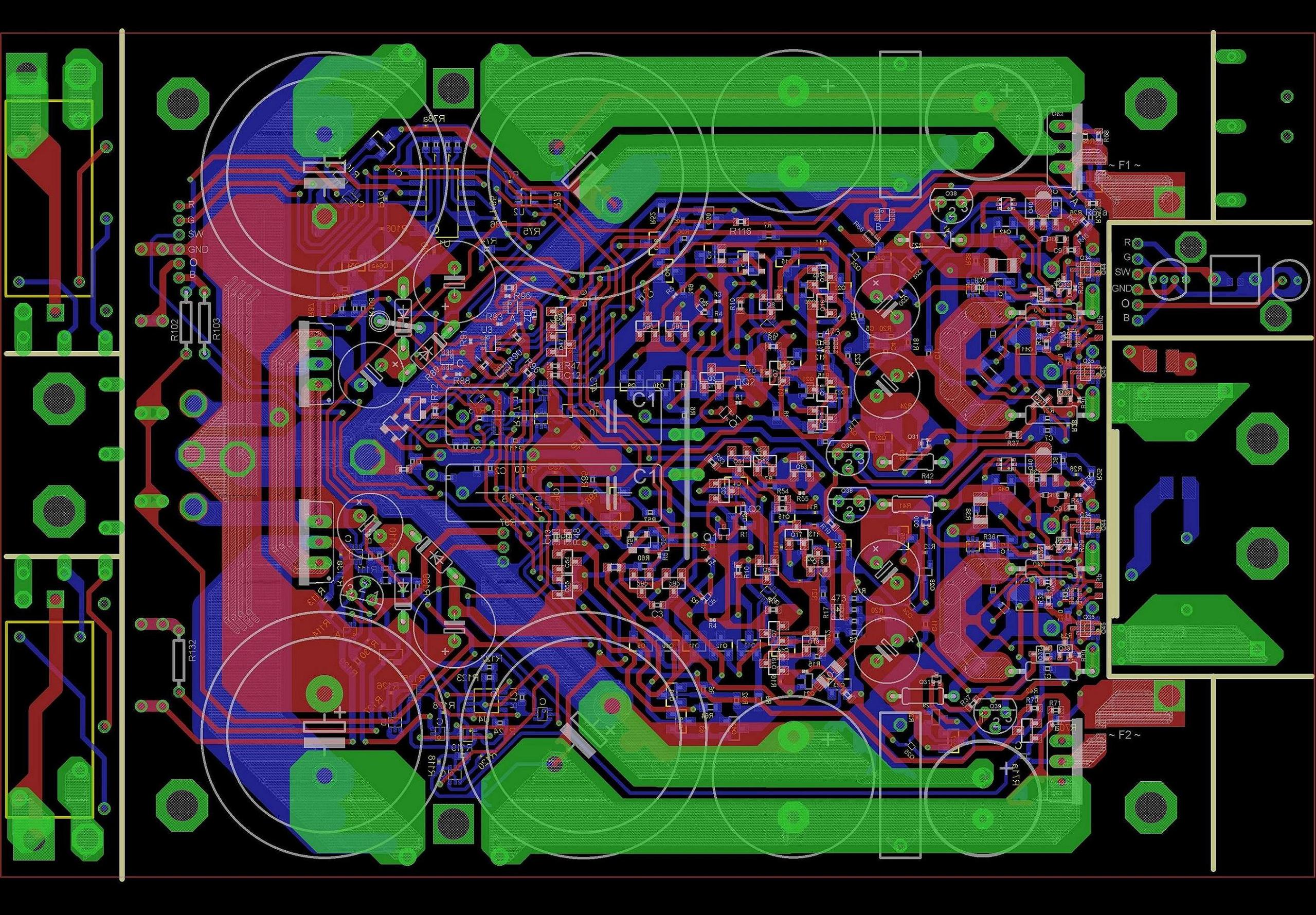

I have a hard time finding the words to express how much I despise SMDs.
I dissagree. Distance on a PCB costs inductance/resistance. If the distance is shorter (including component leads and bonding wires), the effects are less particularly with high frequency RF BW. This prototype stereo amp module that is self contained, thanks to SMDs, in a realitively small area, the output stages are driven by an error amplifier that must work at frequencies well above the audio ban so the shorter the traces the better. There is a lot going on, on that PCB.;)
This one is version 2, as a single 2 sided PCB with daughter boards attached and the minor errors worked out with a few improvements like the addition of relays. This makes it completely self contained and all that is needed is a 35VAC CT transformer, connect the input source, and connect the speakers. It will have 2 seperate channels, DC detection/protection, momentary push button to switch between standby and active mode, where standby mode turns off the output stages/bias. Also clipping detection, short circuit protection, and thermal protection/management with a DC fan control circuit and a thermal cutoff limit.....All thanks to those tiny SMDs.:D

The most common problem with SMD components is that some of them are so small that to troubleshoot or to replace them is a pain in the a$$! You must have Good eyes and steady pulse and do not mention those ic's that have so many legs the size of a hair...:eek:
SMDs come in a range of sizes, some of them are almost invisible and probably violate airborne particulate levels - but there are sizes that are fairly reasonable. I use a size that allows easy handling with tweezers and I can generally read the numbers printed on them too.
