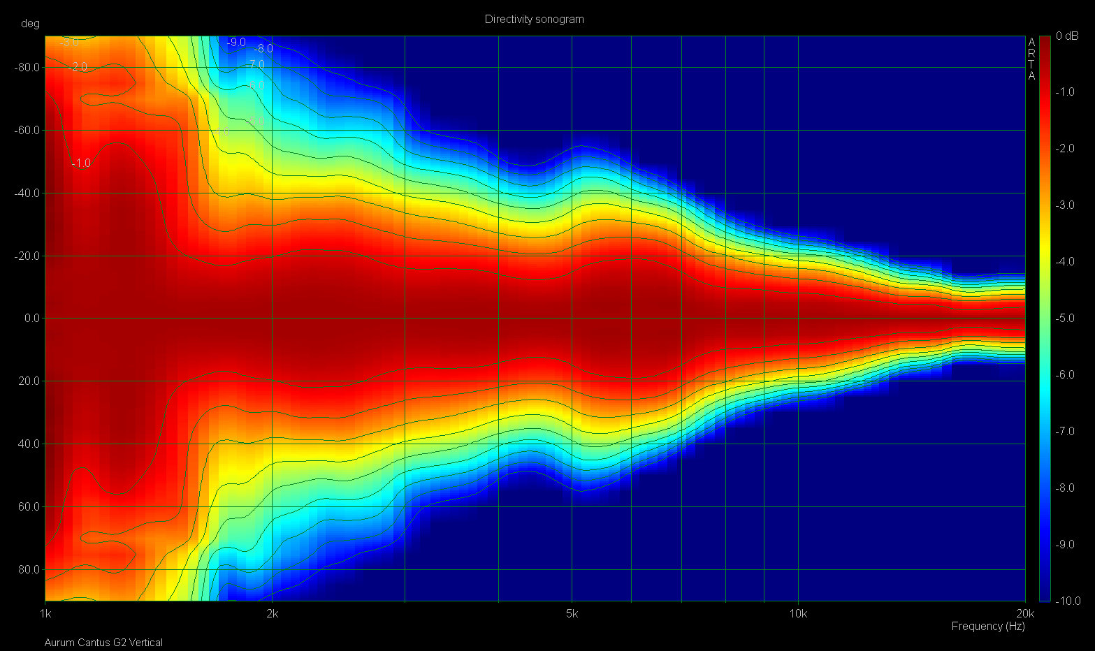

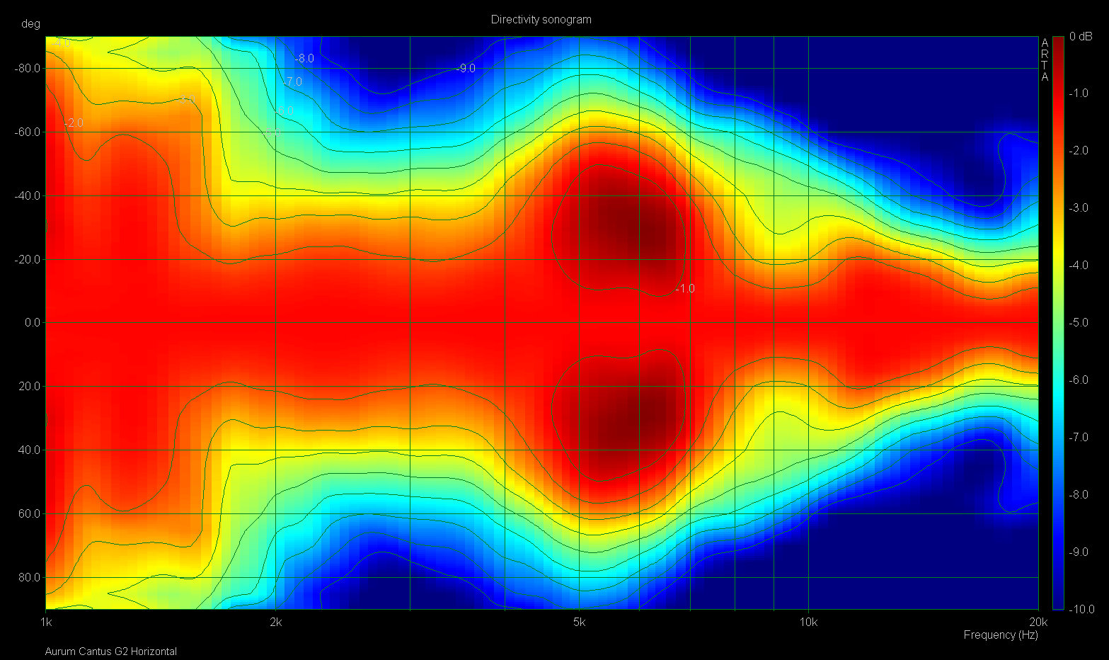

I've previously measured the polar response of the Aurum Cantus G2. Until the recent neodymium price hike they were selling for around $140US which is middle of the road pricing for a ribbon. (There are many twice the price or more even in the same size range, let alone larger ones) I think they sound very good, but that's just my opinion, and I haven't heard any of the "high end" ribbons.So are there any polar maps of a "good" ribbon? Or just opinions?
I took both horizontal and vertical measurements out to 90 degrees in 5 degree steps using ARTA. There is one major caveat with my measurements though - they were taken with the tweeter unbaffled, suspended in space.
Because of this there is a 2dB on-axis dip in the frequency response around 6Khz due to diffraction off the sides of the 110mm round face plate which goes away beyond about 15 degrees on the horizontal axis. Because the directivity sonogram is normalized to the on-axis response this makes the the directivity appear to "bloom" at this frequency, but I believe this to be an artefact of the on-axis dip that would not be present on a proper baffle.
I really need to re-measure it on a large IEC sized baffle but that will have wait until I a have the room and materials to do so...so take it for what its worth.
Horizontally it stays between about 100-120 degrees from about 2.5Khz to 10Khz, ignoring the spurious bloom at 6Khz. Interestingly despite the wave-guide being only about 25mm deep and 30mm wide at the front it maintains horizontal directivity down to about 2.5Khz before the pattern collapses below 2Khz. Vertically directivity is the same below 3Khz, but progressively narrows higher than that due to the length of the ribbon, down to about 50 degrees at 10Khz.
I haven't seen any polar responses published online for other ribbons, so I don't know how this compares to other models.
Simon
Thanks for those. Not really very appealing.
Any chance that I could get the raw data so that I could plot it as well.
I just don;t have a good feeling about the ARTA polar maps.
Simon
What do you find unappealing ? I think you might be expecting a bit much if you're comparing them to large format wave-guides such as those on a Summa whose throat is several times larger than this entire tweeter...
They're about the same size as a typical large face-plate dome tweeter, so should be judged against those. So the question is, is the directivity control significantly better than a dome tweeter ? I think so, especially below 4Khz where a dome lacks any control.
Raw data is 38MB worth of ARTA .pir files, maybe half that size zipped. Too big for the forum but I could email them perhaps. Because of the edge diffraction in the measurement I'm not too happy with their accuracy, however if you want a look that's fine.Any chance that I could get the raw data so that I could plot it as well.
My polar maps, or the way ARTA generates them ? Can you export ARTA pir files to your software and generate them there ?I just don;t have a good feeling about the ARTA polar maps.
