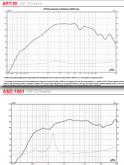

Adolf,
The APT:50 has more output around 3-5K, the ASD:1001 more 5-20K, and smoother response overall, consistent with some of your observations.
The two drivers would require quite different EQ/crossover design to be made to sound similar just from a frequency response standpoint, before even thinking about what the difference in materials are doing.
That said, I have 10 APT 50 drivers, no two measure/sound the same...
Did you equalize the different drivers to the same response curve for your comparisons?
One other detail, the ASD:1001 polarity is a negative voltage at the red terminal causes a positive pressure at the output of the device, I don't recall that being the case with other Eminence drivers, it may be possible that both frequency response and polarity are different.

Regrettably, I don't have such capabilities. I lack good FR measuring equipment. But you shouldn't judge those drivers by the response they give in that particular horn. Sure, they're different, but just as different is the response given by the APT50 driver in the APT80 horn. I use them in a horn in the middle of a Beta 10CX-middriver.
That being said, I've tried both with different crossover points, different L-pads, and so on. Still, my findings stand the same. The APT50 always sounds darker and less detailed. I never managed to squeeze the same dynamism from it I got from the ASD1001, nor the same amount of "air".
Of course it still might be a flaw in the implementation, but in my experience, phenolic just sounds too polite. I'd make a scientific study if I had the resources, but sadly I don't. In my limited experience the titanium driver makes smoother, more natural music. But not without tradeoffs, since it has none of the politeness the phenolic has too much of. It needs good X/O components and good frontend to do it's best. Given that, it's sounds surprisingly natural given it's price.
