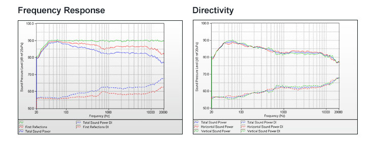

Interestingly JBL deliberately chose a 120° horizontal beamwidth for its M2, maintained from about 700Hz up to 8kHz.
Olive hasnothing but praise for them, measurements look impressive (no polar though), and for what it is worth I have yet to read a negative review on them ("best speakers I have ever heard" being the most frequent citation).
