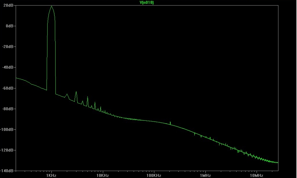

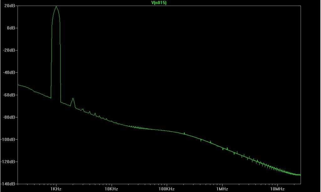

Hi
Here's the thd spectrum image.
The first image are the standard bootstrap circuit thd spectrum.
The second image are the double bootstrap circuit thd spectrum.
Thanx
Paul
Thanx
Paul

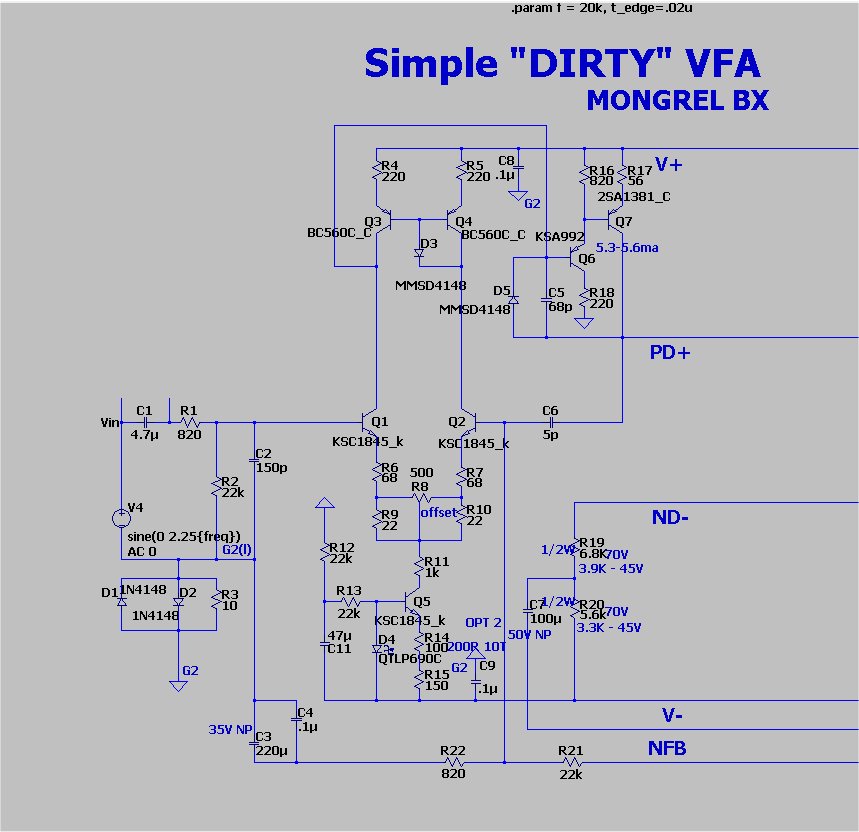

I've eliminated "the rest of the circuit".
I tried this before on my modular EF2 , (below) is the old 2008 "BX"
(bootstrap input stage). It was my favorite in 2008 , we will see how it
stacks up against the latest round of PPM (ultra low THD) amps.
PCB will have the option for a "resistive" LTP source , to see if this has any
SQ effect. The 2015 EF3 output stage has robust cap multipliers (if I use the resistor instead of the CCS).
Simple 6 device input stage has one drawback , more "thump" on startup.
Edit - I even thought about "safety" - clip diode .... and if the clip becomes too
asymmetrical , the protection circuit will trip !
OS
Not sure at present. I simulated a double-current-source version (rather than bootstrapped) and obtained a lower distortion figure (0.025% compared with 0.03%). However, H2 and H3 were pretty much the same.
This might be due to the feedback arrangements - H3 is usually crossover related and the Miller compensation does not help to reduce this.
John
John
Hi Paul,
I don't have this issue on DBS circuit...... I am inclined to agree with John's comment that your feedback situation and compensation issues might be the reason. You might also revisit the bias issue, and ensure that you have a reasonable driver current, say 15mA upper, and 8mA lower. This gives sufficient current to drive the lower gate, and enough grunt to drive the shebang with the VAS collector.
Hugh
Hugh

So Tessier, for his amp in post #54, should reduce the Miller compensation capacitor to 17 Pf and add a 10 Pf capacitor between Q7 collector and Q4 base (it's a phase lead capacitor), and he also should do as Hugh suggested for the drivers current.
