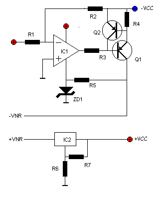

as a negative regulator i suggest you to use the positive one as a reference for a AOP + PNP transistor regulator.

It is just a tracking voltage regulator using an op-amp and a couple of transistors to generate the negative regulated voltage. All of the red "+" are connected to the output of the LM317 which provides the positive half of the supply output. In addition you need a negative voltage to feed to the negative half of the regulator which I suspect should be around -20V or so. It's quite clever and will work with either a conventional CT transformer and bridge or independent windings with separate bridges for each rail.
The op-amp uses the positive supply from the LM317 as a reference and is configured as a unity gain inverter, it in turn drives a non inverting transistor buffer which provides the actual load current. The whole thing works by comparing the negative output to the positive regulated supply and makes the negative rail track the positive. Q2 and R4 provide current limiting and short circuit protection by reducing the base drive to Q1 under overload conditions. R4 samples the output current and causes Q2 to turn on when the voltage across it exceeds 0.6 - 0.7V depending on the transistor used. For example a 56 ohm resistor at R4 would limit current to a little over 100mA.
Note that this a little more complicated than using the floating LM317 mentioned in earlier posts.. FWIW I would probably stick with that topology as you just build two identical regulators that are completely isolated from each other and then ground the "+" out of one to produce the negative supply and the "-" out of the other to produce the positive supply.
