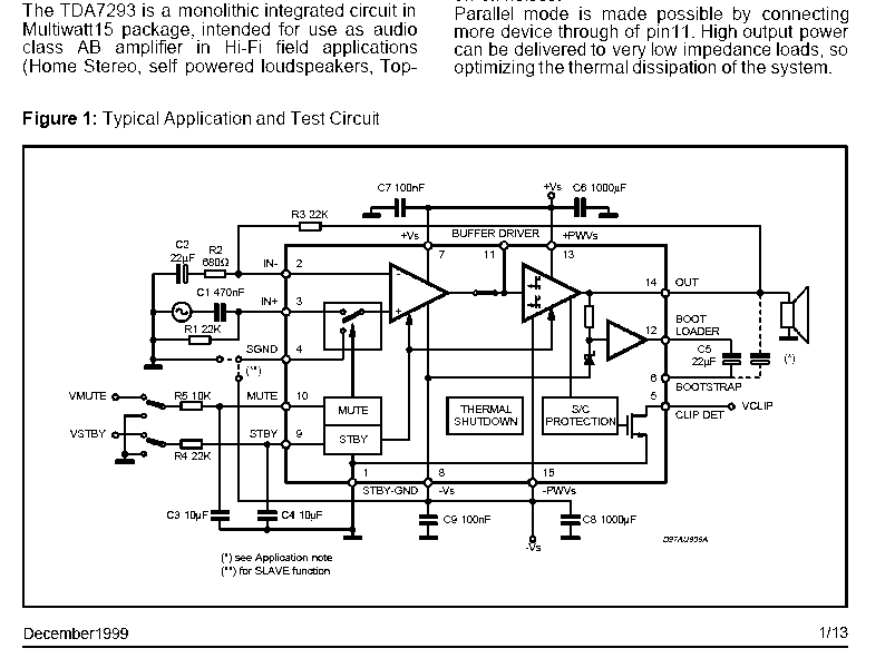

Pin layout of TDA7293/4 is stupid crazy, the designers bring internal connections whick *must* be joined, to non contiguous legs. Stupid.
Pin7>13 and Pin8>15 :eek:
Why didn't they spend 5 minutes more rerouting the *internal* layout , or even better joining said points *inside*.
Worst case, they could do it the hard way, adding the necessary couple wires at the die itself, before encapsulating.
This complicates PCB design, of course, and , as Art M correctly says, nothing the PCB designer does will change that.
On the contrary, LM3886 pin assignation is very good :)

It's the reason the TDA could be better than the LM - it has SEPARATE input and output stage supply pins, which is great.
I wish the LM had these.
Well, it "could" ... ;) but since everybody uses them joined ... even the datasheet example :eek: , I stick to my opinion.
And anyway, even if that was the original idea, they still might have used contiguous pins, so both options are easy to choose.
As is, it unnecessarily messes with the PCB layout.
In both cases they have not 1 or 2 but 5 or 6 legs in the middle.
If course, *she* also thinks that crisscrossing those tracks is no big deal:
That's a good reason to go double-layer PCBs and reconsider the tradeoffs of trace length, inductance and current loops.

The main, heaviest current path is between the output stage rails, TDA's output and GND pins of bypass caps. This region should be as small loop area as possible.
What do we see on eBay (and lots of other PCBs)? The supply comes 'round the left/right edges of the board. Huh.
Bypass caps, as close to the IC as possible? Nah, they are subminiature and placed at the farthest place possible - on the opposite corners of PCB.
