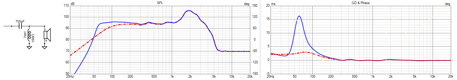

Group delay is potentially audible.What mechanism in EQ-ing a sealed enclosure causes it to mimic the stored energy of a ported speaker's Helmholtz resonator, and consequential long decay times to a step response.
![gd.png gd.png](https://www.diyaudio.com/community/data/attachments/1219/1219027-4364d601be7721db4eadc7946d71400f.jpg)
I was only enquiring whether you had an objection to making it leaky.You don't think a wood box can be made air tight. I disagree.

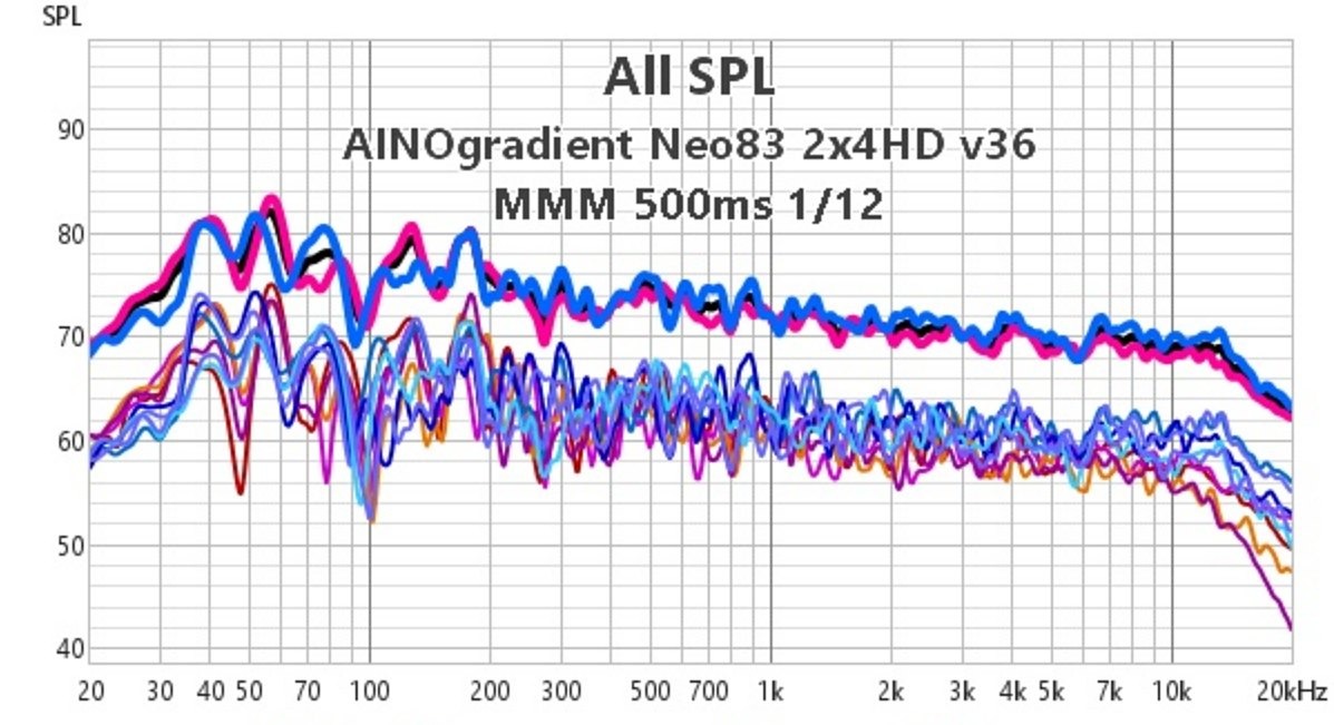

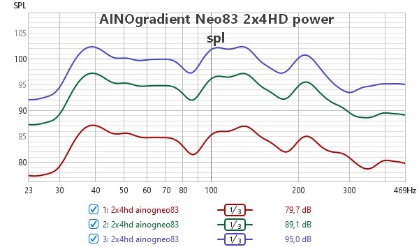

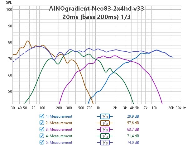

Here my AINOgradient's latest PEQ settings of the woofer, and some measurements. All done in-room so I don't show impulse, decay, distortion etc.
Sealed woofer is SEAS L26ROY in 30 liters, some stuffing. Downfire against the foor and nearness of front wall give some boost. XO around 150Hz acoustic LR2 to dipole 12" mid.
Thread https://www.diyaudio.com/community/threads/aino-gradient-a-collaborative-speaker-project.231353/

![ainogneo83 2x4 v36 LR MMM 500ms 112.jpg ainogneo83 2x4 v36 LR MMM 500ms 112.jpg](https://www.diyaudio.com/community/data/attachments/1219/1219054-a340cfd55ab41a8425d67c595f5d0641.jpg)
![ainogneo83 2x4hd v33 all ind 20ms 13.jpg ainogneo83 2x4hd v33 all ind 20ms 13.jpg](https://www.diyaudio.com/community/data/attachments/1219/1219056-488011da07c3aa1144ef6daf0b3a296e.jpg)
![ainogneo83 2x4hd power spl.jpg ainogneo83 2x4hd power spl.jpg](https://www.diyaudio.com/community/data/attachments/1219/1219058-8ae691d26fa389694db5e85dd655b372.jpg)

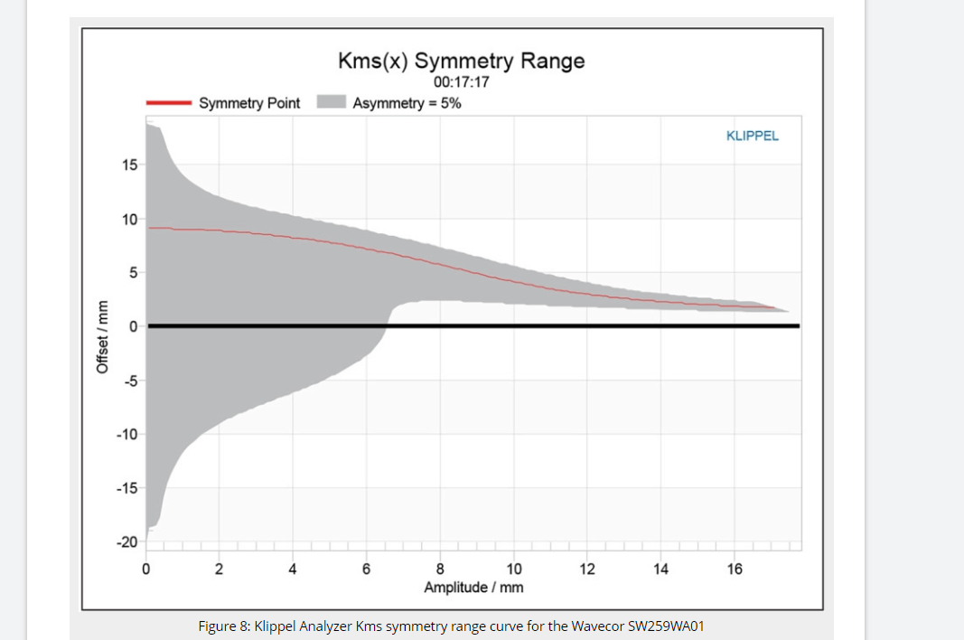

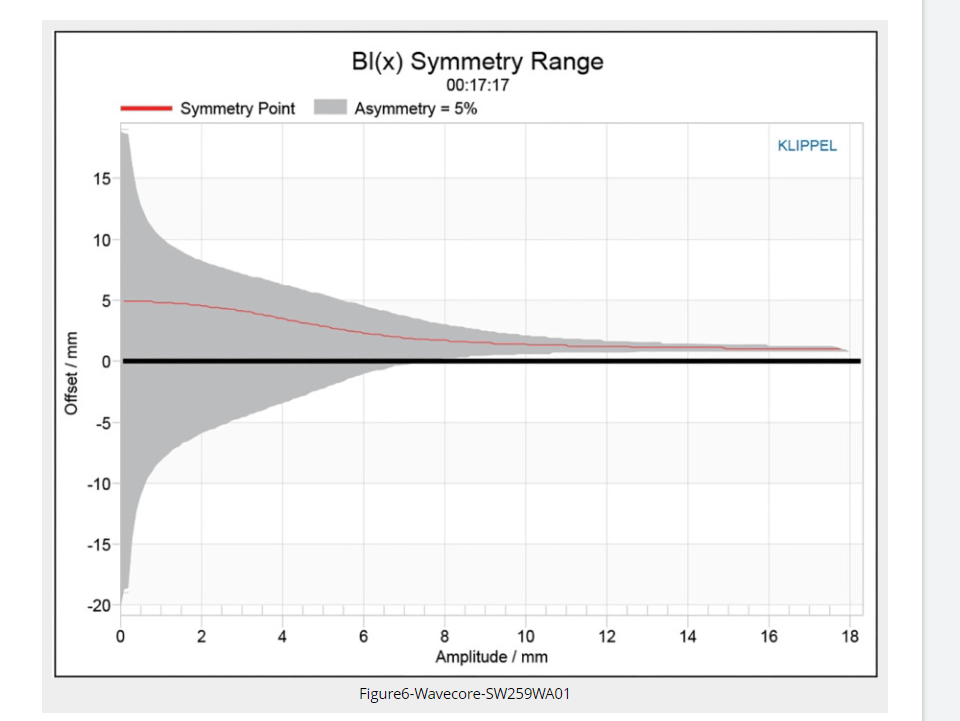

example klippel data here:
https://audioxpress.com/article/voi...cor-s-new-sw259wa01-10-25-high-xmax-subwoofer
Both suspension stiffness Kms(x) and motor force Bl(x) are biased positive, which I think means the voice coil is naturally biased bit outward. If this driver was put cone toward floor it would make bit more distortion than regular vertical orientation. If cone was toward ceiling it would make bit less distortion. How much? I've got no idea. Notice how the symmetry changes with excursion and so on, so it's quite complex. I think best would be to listen and measure, if performance is significantly worse in horizontal orientation than vertical, perhaps consider another driver.

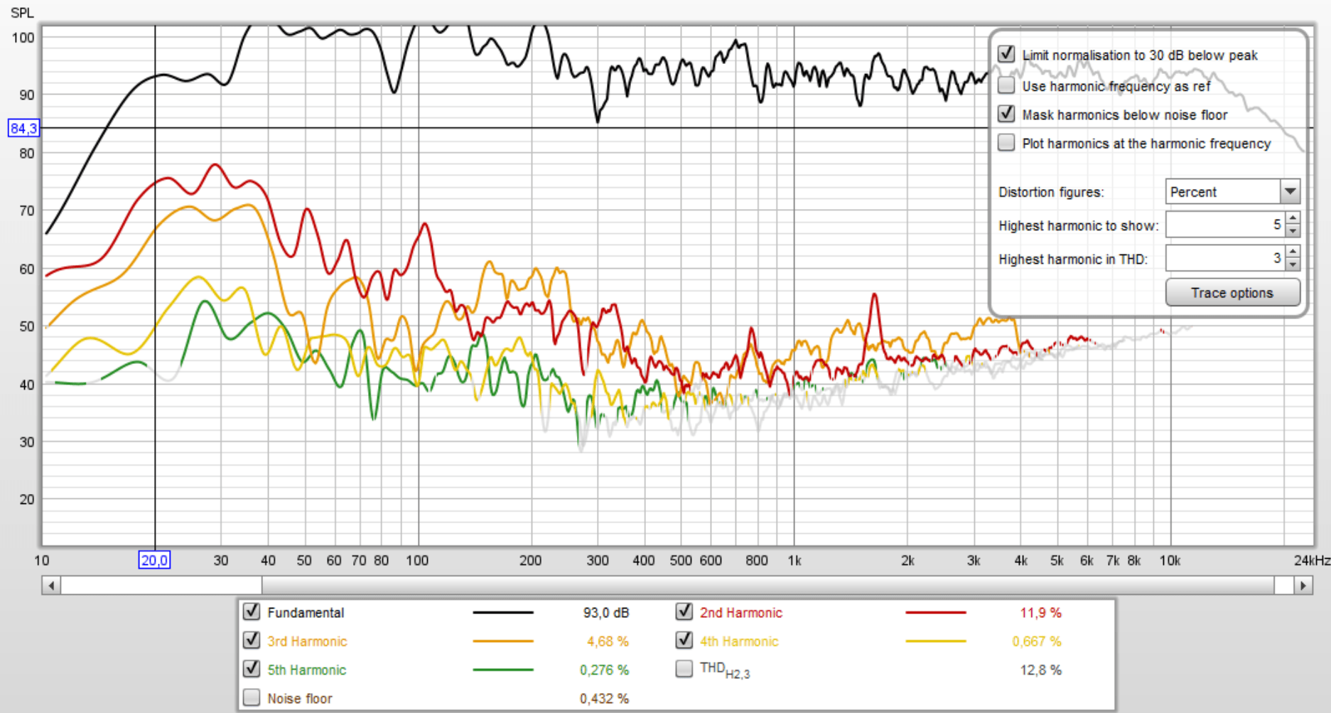

Err, I don't follow you. If a LF speaker distorts 10% H2 at 30Hz, the percepted H2 is only 5dB under the base frequency. If the H3 would be 10%, it actually would be louder than the 30Hz. But you know that. It actually is a well-used phenomenon in small speaker design. There seems to be bass, but there isn't.Distortion at lower frequencies is actually very difficult to hear?
