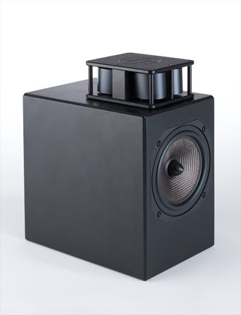

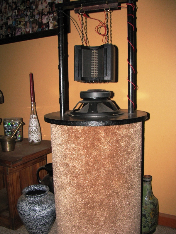

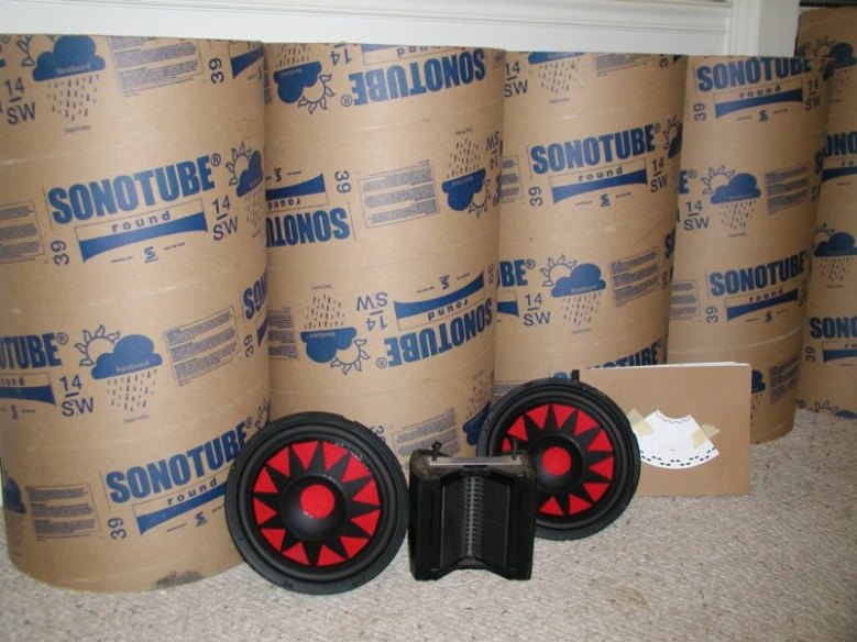

I'm thinking of going after something alone these lines Bella 5 - Products - High Emotion Audio along with a tapped horn for the lower stuff and a pro 6 inch driver with PR on the back side of da box. Probably start out with an Eminence 6 Eminence Alpha-6A 6" Midrange 8 Ohm or something of the sort. I would still use the AMT1's for the high stuff but I prefer to cross them pretty high up.
I would luv to get my hands on a pair of the tweeters High Emotion Audio is using. I got to listen to a set of bella 7's and it is a very nice speaker.
They are made here in Nashville and I know a guy that knows a guy that sez he will see if something can get worked out. I'm not holding my breath about that tho..... Plus I already have the AMT1's sooooooo no need to spend a buncha $$$$$ for something else.
The Bella 5 looks like it uses a variant of a linaeum tweeter. You can see the measurements of the original tweeter here:

It is in fact an updated linaeum tweeter - High Emotion Audio purchased the rights to the linaeum driver and then added some improvement - which they have patents on - Patent WO/2007/079441A2
In this article the writer - Scott Wilkinson - mentions the use of a new linaeum driver - Let There Be LET | Ultimateavmag.com
After hearing it for about 5 or 6 hours I can state that it is one heck of a driver. Good horizontal dispersion but vertical dispersion needs to be paid attention to.......
