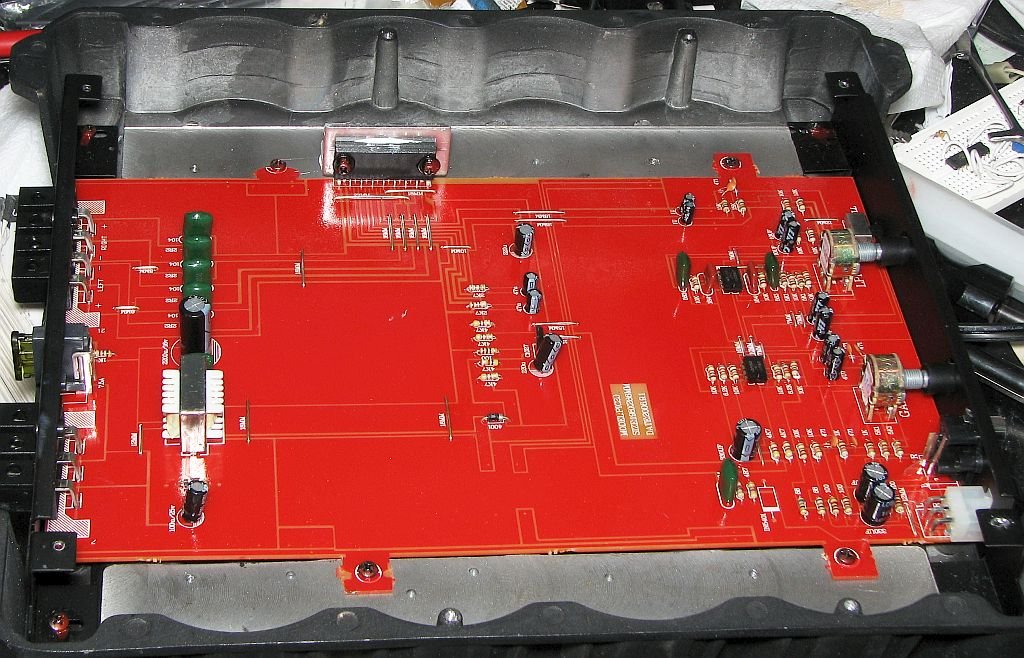

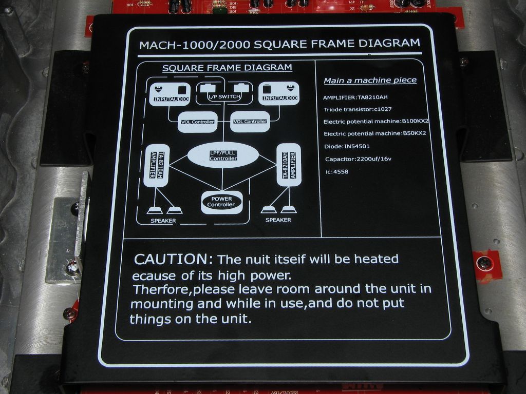

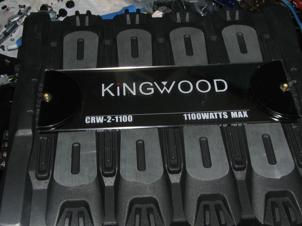

Was it as bad as this Kingwood?
Reactions: 1 user
