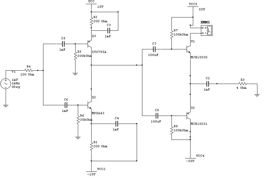

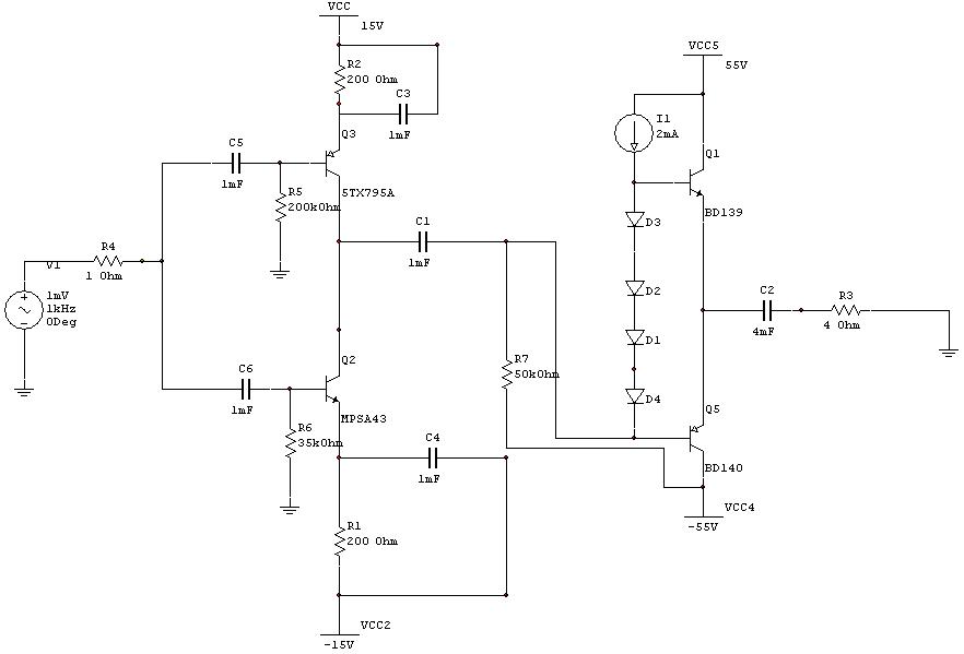

please take a look at this amp. I know it's not good , but it's my first one, I'm not thrying to be the best, but just to make it work. Against multisim 7, for the 1mv signal I'm getting a 1.9V peak-to-peak output for the 4Ohm resistor load with zero DC level. Seems good, but the problem is a little distortion on the output signal: its lowest value is - 0.75V and the highest is about +1.2V. Therefore, the output is not a valid sine wave, since it's not symmetrical with respect to time axis. I know I must use negative feedback to correct this, so I want suggestions about what to do to correct this amp using feedback. Please take a look and try to teach me.
well, when u see a single bd139 you should see 4, but I was lazy enough to decide to put a single one. On the other hand, each transistor is dissipating about 10W rms (Ic = 285mA, Vce(rms)=30V), so there's no smoke. Please, if u don't know what to say, don't say ********... just don't post.
ashade said:Please, if u don't know what to say, don't say ********... just don't post.
the guy was trying to help you: from the schematic you posted, you will need a lot of help to get the amp to work.
ashade said:well, when u see a single bd139 you should see 4, but I was lazy enough to decide to put a single one. On the other hand, each transistor is dissipating about 10W rms (Ic = 285mA, Vce(rms)=30V), so there's no smoke. Please, if u don't know what to say, don't say ********... just don't post.
4 of them will not be able to do it either, not in the real world. In fact, looking at your schematic, it has about the same chances of working outside of a simulator, as a snowball has in hell (Look up some data on semiconductor parameter tolerances, as well as secondary breakdown - neither of which are modelled ina simulator). Still, since you do not seem to be willing to learn from answers you get here, we will just all let you learn for yourself.
hi ashade,
when looking at your schematic I can see that R7 and Q5 act as a simple resistor load for Q1. Assuming that Q1 and Q5 have a beta of about 150, the maximum current Q1 is able to source is 150 * 2ma = 300ma. No wonder that you can't get more than 1,2V positive voltage swing.
The same with the negative voltage, you build a nice voltage divider. 55V * 4 ohms / (4ohms * 50k / beta) = 0.65V. No need for simulating this.
D1 to D4 in your schematic are useless. They do not bias anything. If they would they'll blow Q1 and Q5. Trying to get your amp running is a waste of time. Sorry to say this, but there is no potential in. You designed this amp by throwing some parts in the simulator and trying to get it running. Probably you're also simulated it wrong, at Tj = 27°C, which will never fit the realitiy for the output devices.
Youl'll better try of one of the JLH designs. They are running and have no differential input. You can simulated it as well as building it. After that try to vary the resistor, capacitor and transistor values / parts. Simulation models never fit the parameter variations of real devices. There is only one parameter which is quite independent from parameter variations: Vbe. But only for the same parts at the same temperature.

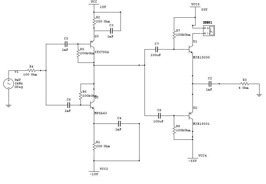

I've changed that schematics to this one below. A temperature sweep test told me it works for a range of about -20 .. 50 ºC. Of course it needs to be improved. Now I'm getting low distortion due to max negative/positive output voltage swing, but it still happens. Also, the capacitors are too large and the frequency response is not good for the bandwith it's supposed to work on (20Hz-20kHz). Now, please see the schematic and post your comments. Be nice this time and remember I'm just a beginner and not a pro like you,
There are still major problems with your circuit. All four transistors are biased full on, the first stage will never swing more than 15vP-P so unless you give the second stage some gain the 55v rails are pointless.
I suggest you try simulating some popular amps and play around with modifying them until you are ready to design your own.
