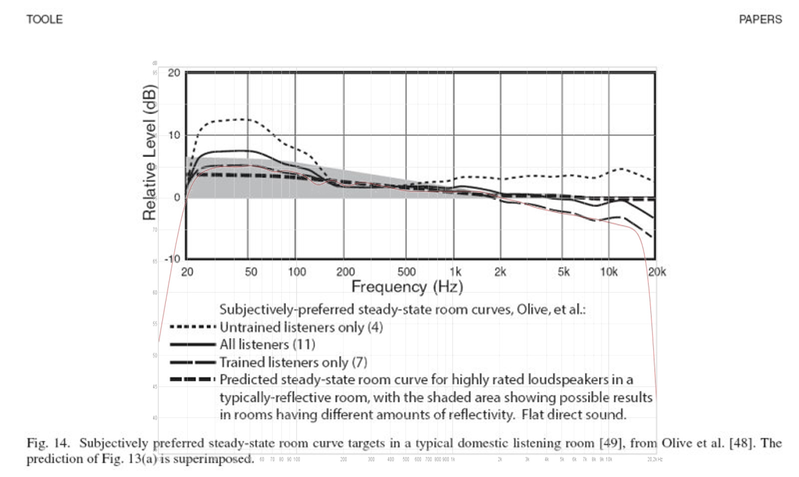

This could be called EQ-ing for preference. However if I overlay it on the listener preference graph as defined by JBL/Harmon I might not be all that different from other listeners at JBL:
While I arrived at that (red) curve by simply following my own preference over time, I now simply aim for the preferred listeners curve if I redo my EQ work. On top of this I still use mid/side EQ as discussed within this thread.
The listener subset used in that graph is a small one (11 listeners) however it is clear to see not everyone will have the same preference.
