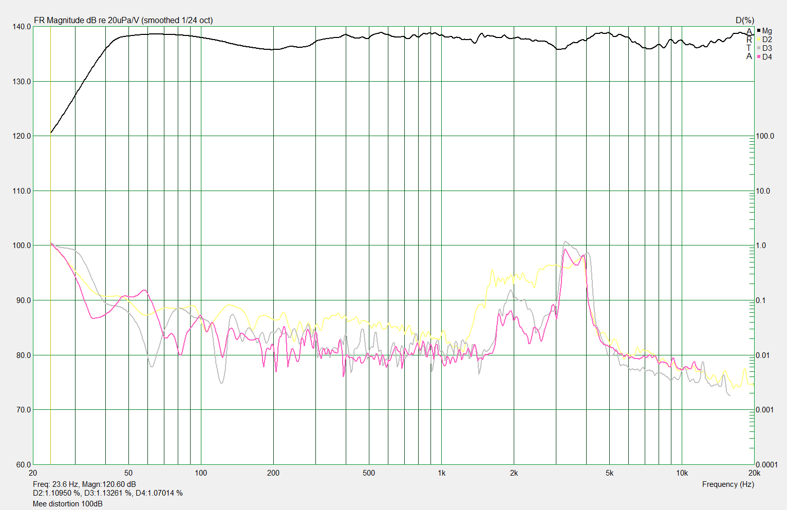

This is 100 dB at 1 meter anechoic. Smallish speaker <6 kg.
