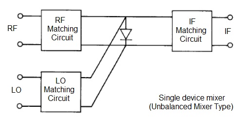

Maybe a way to explain harmonic distortion in relation to intermodulation distortion is by looking at the diagram attached below of a very basic type of RF mixer circuit. Suppose we put one signal in at the input labeled RF (with some DC bias on it so the diode is always forward biased maybe at 0.5 VDC, and we keep the AC part of RF signal not too big like maybe 0.1V peak to peak. With just that one signal present as the input, the output would show a lot of harmonic distortion.
If we then put in another AC signal at the input labeled LO, and we don't let it get too big, maybe 0.1V peak to peak, what we would see at the output would be a lot of IMD.
Nothing has changed with the diode, the thing responsible for the distortion, in other words, the nonlinearity is exactly the same.
Maybe the above description can help illustrate how THD and IMD can be two different ways of looking at the same nonlinearity, since the diode has stayed exactly the same. I think that's what Earl was trying to get at in what he was saying about THD and IMD.
I can't say I have the background to understand the circuit. I'll take another look at it though.

IMD is the result of an interaction between two different frequencies
Maybe a better way to look at it is that IMD is the result of both frequencies interacting with the nonlinearity at the same time, rather than them interacting between themselves.
In the case of the diode circuit, distortion is caused because of the diode's resistance change according to the voltage across it. If only one frequency is present then only that frequency is causing the resistance change. If two frequencies are present, then each frequency sees resistance changes from two different causes at the same time. That's what makes the IMD.
Of course, in reality everything is changing at all at once together, not as independent sub-processes. But, I'm trying to see if I can help get you thinking in a different way, hopefully developing more of an intuitive sense of how THD and IMD can be the same thing in a certain basic sense, the same nonlinearity effect, just different outputs only due to different inputs, not with any difference in the underlying mechanism that is causing distortion.
It sounds like what you're saying is that IMD is the distortion resulting from multiple frequencies playing at the same time, whereas harmonic dis is the result of a single frequency being played. So they don't coexist. Is this correct?
