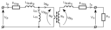

To the extent there is coupled flux, it makes an air-core transformer with a shorted secondary. Some of the inductance of the secondary would be reflected to the primary.

The effective resistance of the shorting secondary turn is equivalent to a lumped resistor in series with its leakage inductance, all of which is in parallel with the inductance due to flux shared between primary and secondary (considerations subject as appropriate to scaling according to turns ratio).
In the transformer equivalent model, if the secondary is shorted then only leakage inductance is reflected back to the primary (neglecting any capacitance). If the secondary is open, then no current flows in the secondary and nothing to reflect back to the primary.
Are we in agreement that far?

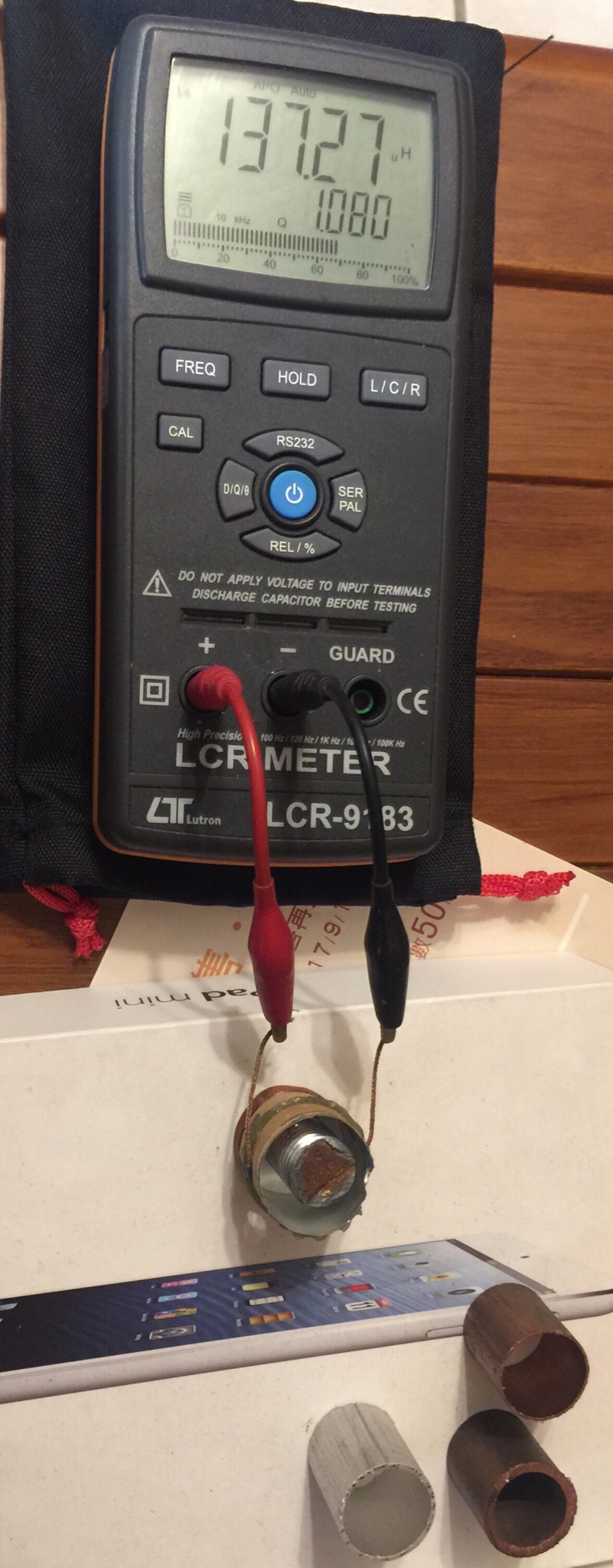

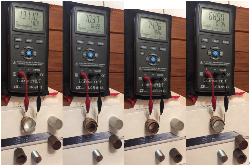

From the left, the first is the inductance of just a voice coil, the second has a copper ring insert, the third has a thinner copper ring insert, the forth as an aluminum ring insert.

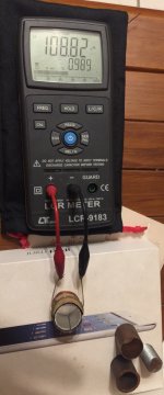

Below, I added an iron core which was cut off from a screw into the center of the aluminum ring.

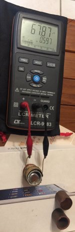

Below is just the iron core inserted alone.

Yes, the shorting ring does lower inductance. I am going to take some time to look at the impedance curves of just the voice coil. Lots of literature indicating shorting rings reduce inductance distortion, I also have a driver which the manufacturer added a shorting ring into the design and lifted the response of the higher frequencies. I was exploring ring thickness and material effects. Seems aluminum reduces inductance more.
The idea came from a different thread which mentioned an Audio Precision filter for testing class D amps used an aluminum shield to block external metals from influencing the inductor performance. But I also wondered why most use copper shorting rings. Since BMS uses aluminum, I guess it should be a good material to use.

So, if we have conducting cylinder as a secondary, and it's resistivity is low, mostly what happens is we have it's leakage inductance in parallel with the primary magnetizing inductance, and both of those in series with the primary leakage inductance. So inductance seen from the primary terminals drops. This is about the same as having shorted secondary in any transformer, the inductance as seen from the primary terminals goes down. Is there a problem I am missing?
