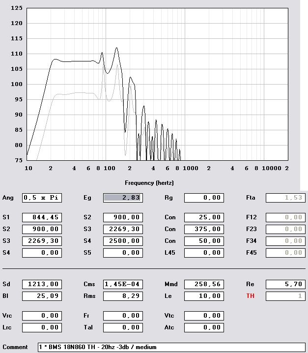

sek said:If we really want to improve upon what we got, I think a tapped horn (with an appropriate driver choice) would be the way to go.
Here is a 20hz TH for the 18N860. 700 liters and 125db max (in half space, 135db in eighth space) from 20-150hz. Grey graph is half space, black graph is eighth space. You would need to build two resonators in it to tame those peaks. You could make it somewhat smaller at the expense of efficiency.

The limiting excursion peak in my simulation is around 30hz, so a highcut wont help much to raise max spl - besides, a highcut is mandatory for a tapped horn (20hz in this case). if you make a horn for a 30hz cutoff, the spl limit increases to maybe 130db while size will go down.

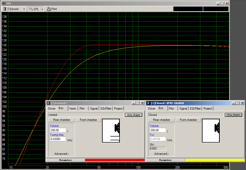

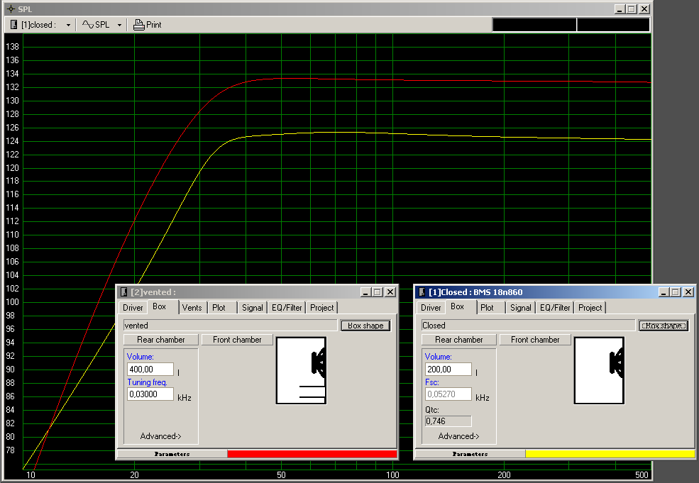

But please note that the closed alignment, delivering 125dB@40Hz and 120dB@30Hz, is at it's excursion limit.
The vented alignment has some considerable headroom here, safely delivering about 132dB@40Hz and 128dB@30Hz (with 5kW peak power!), see attached graph.
So putting a single 18n860 into your 200l box and giving it a vent would be the more efficient approach (read: half the price, twice the output!!!).

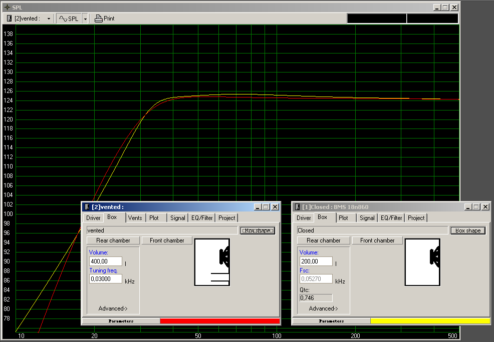

No, don't! I've supplied you with another graph, showing both closed and vented in comparison. Both single driver, high pass filtered, driven with the same power (2kW) at the respective excursion limit. The closed box fares pretty good (for a closed box, that is ), so leave it alone until you really miss the lowest registers. I predict that you won't!
